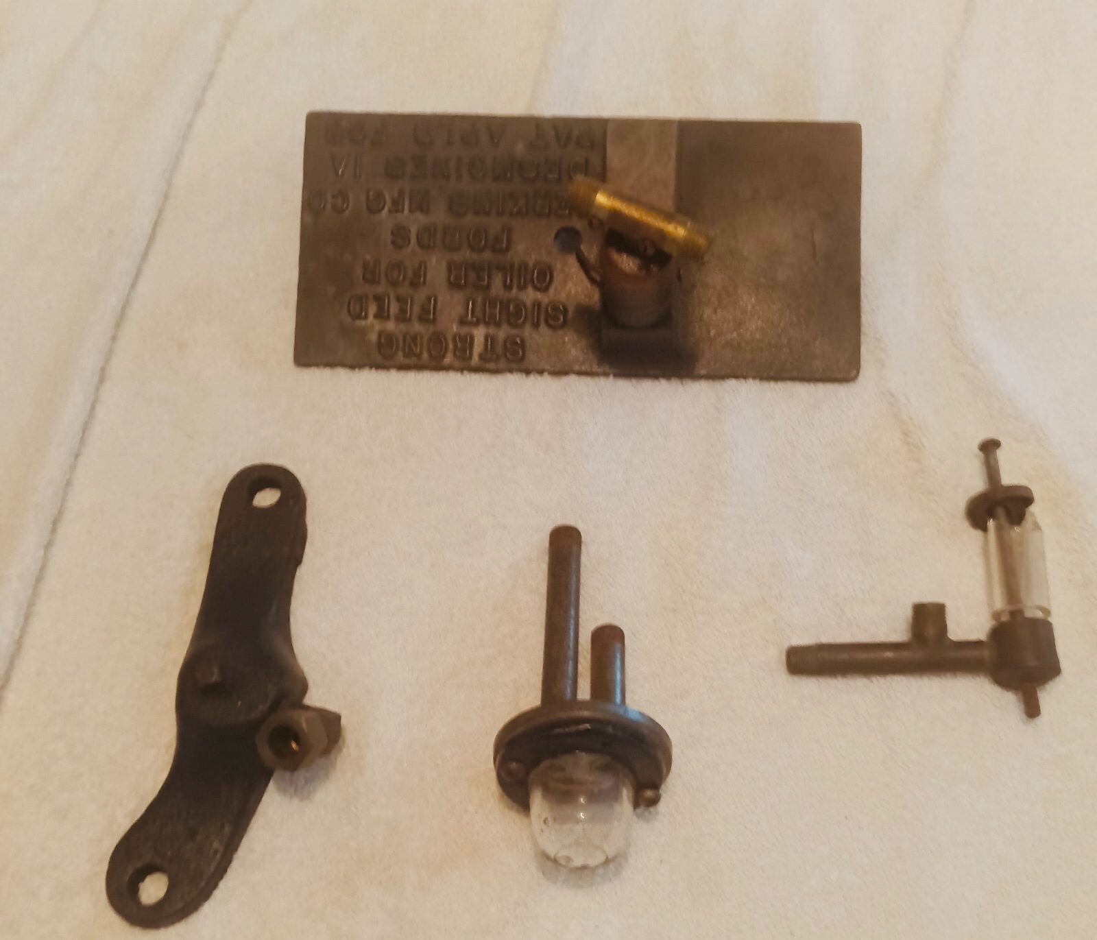

Thanks Jay! I don’t have one Norman. I just think there neat and didn’t know if they offered it for the later blocks. The picture is from a recent classified ad that had sold.
Bryant
Posts: 4084
Re: Strong Site Feed Oiler

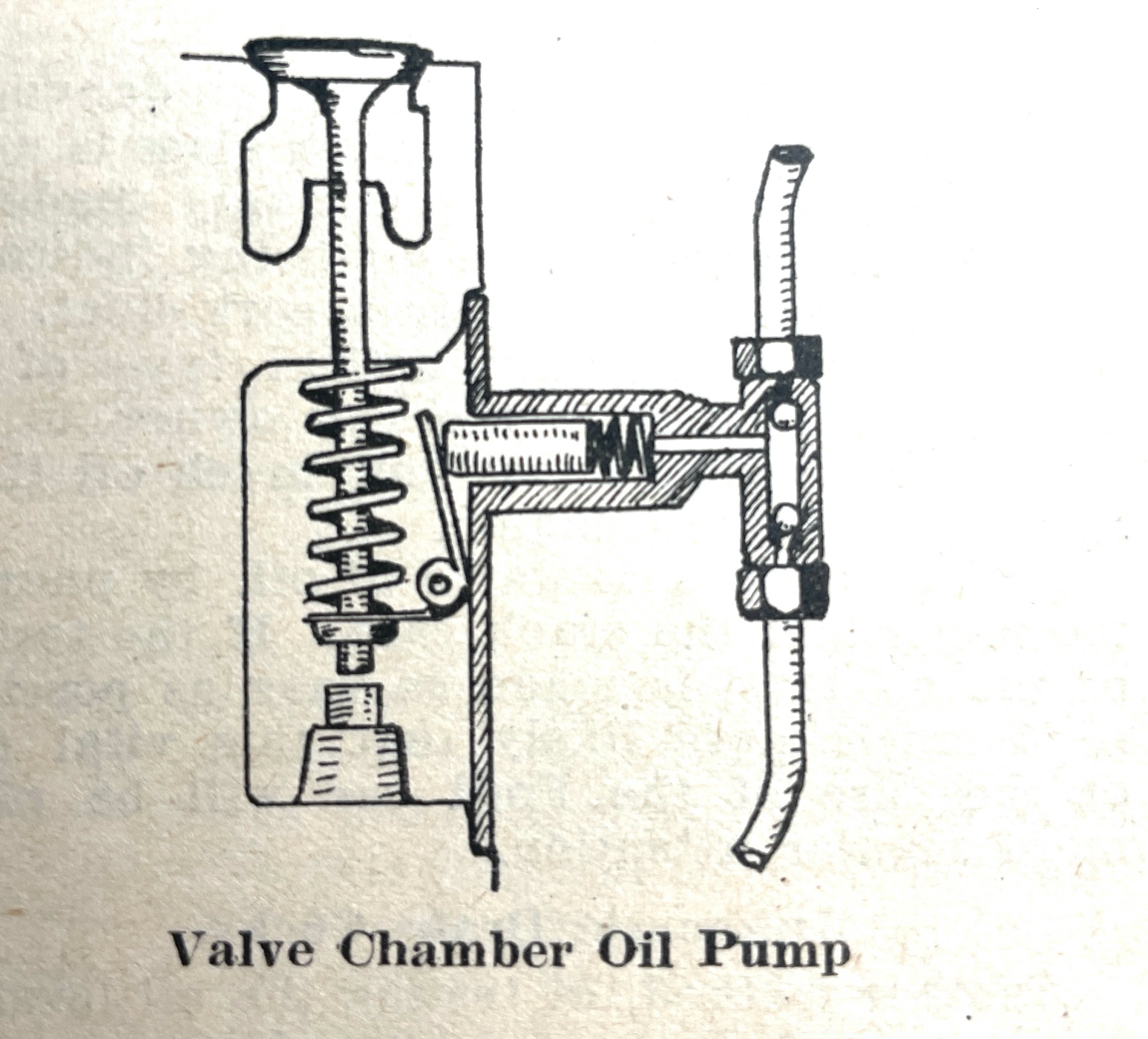

Post by DanTreace » Mon Feb 19, 2024 2:16 pm
If that plate has a lever on the inside, that could be accessory pump to push the oil. Since it's complex, likely few sold, and wouldn't be also made later for the one-piece cover.
Info from Sept. 1920 Ford Owner and Dealer magazine.
Post by Norman Kling » Mon Feb 19, 2024 10:18 pm
I suppose it would be useful for going up steep hills to get oil to the front of the engine. However, you would also need something to get the fuel to the front too. The 26-27 solved that problem by raising the gas tank, but still needed auxiliary oiler to get oil to the front.
