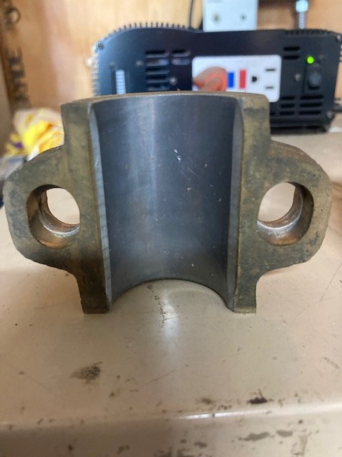

Anyone seen a cap like this? Are the adjustments for thrust uptake?

I have several types but not like that one !

With the 2 grub screws only to adjust one way, I'd say it's purpose is to close the mag gap.

It’s an adjustable main cap. A old trick to get you by with an original cap is to use a rat tail file and slot the holes enough to move it in closer. The best location to do this is with the rear main to lessen the end play.

I took the liberty to adjust the picture.

Hi Douglas,
This is one I picked up a few years ago, it's a little simpler design but should work the same. I would bet it was a fast repair for a otherwise
time consuming repair.

Adv for that type of cap to manage end-play.
And a couple of more devices to keep the mag strong ;)
