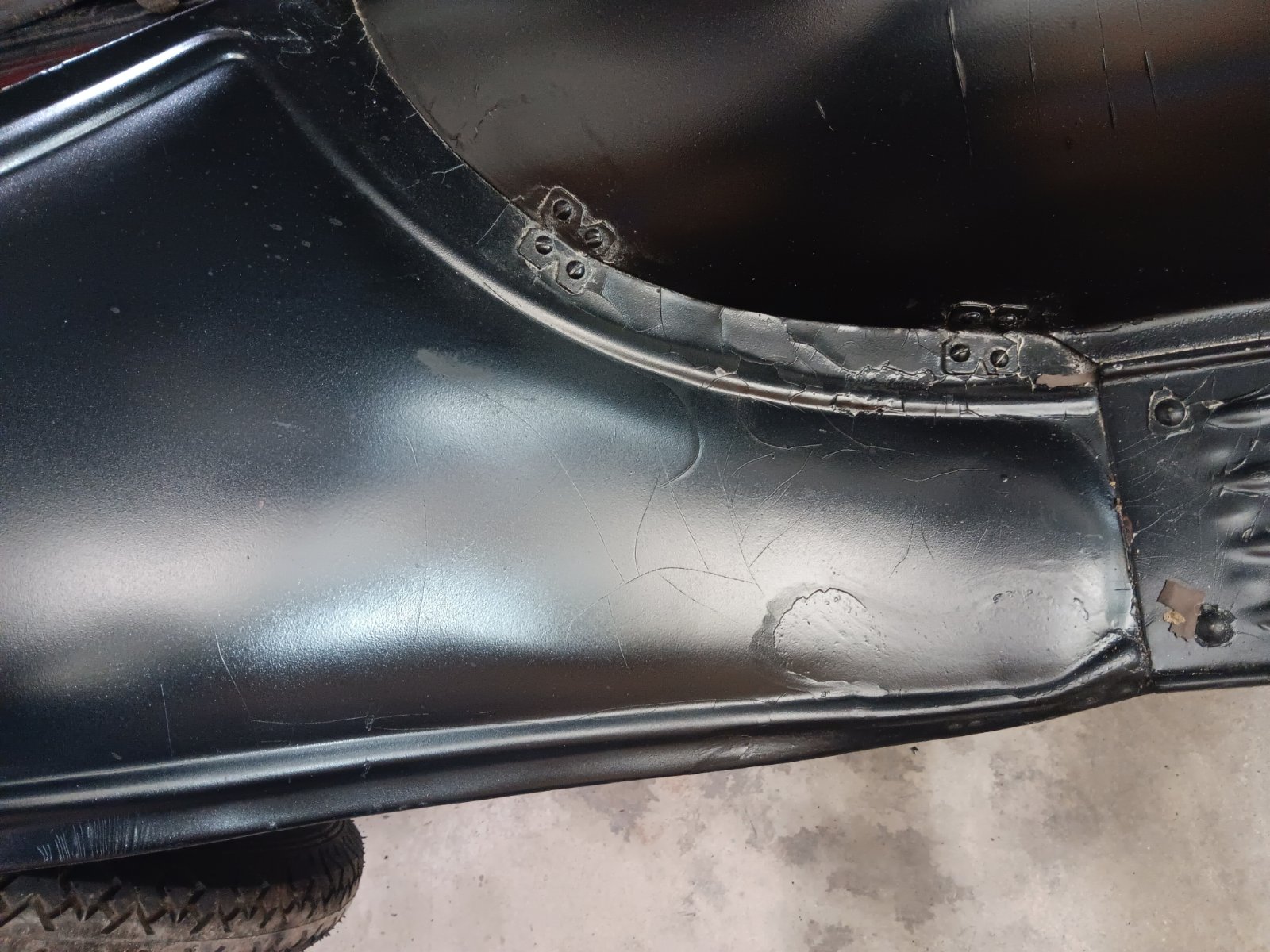

				Here are a few pictures of the cracks and stuff that i was talking about. The paint has some 'orange peel' in it as well.
My goal is just make the car a little nicer, im not really all that worried with the cracks. If i do end up painting it someday, it will be red. The car used to be a fire cheifs car when it was new, there's stilll some red left under the radiator shroud, and is wearing through where the door latches are. It also has a hole right in the middle of the windshield that is used to mount a spotlight (which i do have) but i must admit, looks kinda out of place on a 'regular' black car.
 we also have a TT firetruck that is red, and if it was was painted like that I think that would be pretty neat!
I bought some of that meguiars compound, like in the image above, but it didn't help me much. The pictures were before i tried the compound.

				It has a nice satin look. I wouldn't be ashamed of that at all!
				Re: Polishing up spray painted T?
				Posted: Thu Feb 22, 2024 10:31 pm
				by jiminbartow
				That does look a lot like lacquer was painted on top of enamel, creating those cracks.  Everything I suggested I still stand behind.  Sand the finish to smooth the surface, mask off and paint with Gloss Black Appliance Epoxy.  The difference will be stunning.
				Posted: Fri Feb 23, 2024 3:03 am
				by Allan
				You guys must have been kissed by the fairies if painting over the top of that paintwork will work. We have nothing that  know of which will last painted on over a suspect substrate like that shown in the photos. Something is going on under the black coat, and putting another coat over the top is not likely to fix that. There is something which is incompatible in the layers underneath. I could use epoxy enamel to get a clean and clear finish, but I would not expect it last. Enamels are most forgiving, but even they have limitations.
