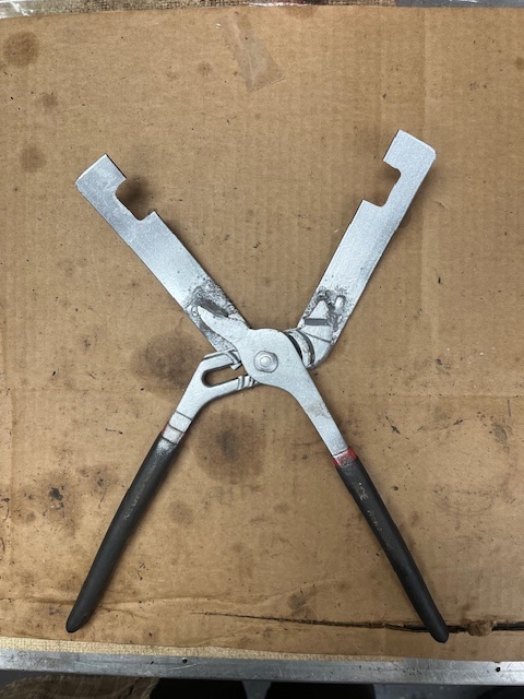

I repurposed a broken channel locks

We recently reinstalled our rebuild motor in our T. The rebuilder told me that if you turn the universal so there is a corner at the top, it would be easier. It was a good suggestion, and worked well.
The pictured tool would keep your fingers our of harms way and may be better solution.
