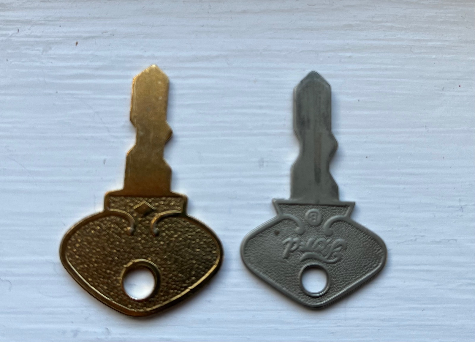

The Vintage Ford Magazine article specifies the Manufacturer of the key and Not the Number.
We have 2 trucks and it appears they both have the same keys without numbers. Clum being the manufacturer. Can anybody figure out a number for these keys? I would like to purchase a couple of extras, just in case. Thank You.

Terry,
Those keys are the ones that come with the new reproduction switches. They are not Ford keys made by Clum or period aftermarket keys even though they have the Clum mark.
Langs and Snyders both stock duplicate keys for them. When you call to order just make sure you tell them you need a key for the new reproduction switches. They both have them in stock.

Steve,
They are “close” to a 55 key but there are some differences. On some occasions a worn 55 key might work but not always.
Here is a picture of a key that came with the new switches next to an original Ford script Caskey Dupree 55 key. The tooth profile is “close” but not exactly the same. Look at the groove that runs the length of the key and you can tell that on the key that came with the new switches runs to the left of the center or point on the key and the Ford 55 key the groove runs to the right of center on the point of the key.
When you lay the two keys on top of one another you can see that there is also a slight difference in the spacing of the tooth profile.

When matching keys start with the keyway (groove). They are either centered or off-center to the left or right. Basically the same cutting, could be used for 3 different keyways resulting in 3 different lock combinations.
It is not a #55 see the offset
Looking at ID chart I created - looks to match a #56key

Frank,
The groove or keyway is on the same side as a 74 key but the tooth profile of a 74 is also slightly different than the keys for the reproduction switches.
Here is an original Ford script Briggs 74 key next to a key for the reproduction switch.
Close but not an exact match.
Again, like the 55, a worn 74 key “might” work in some situations. That’s why I would recommend if you have a reproduction switch to buy a duplicate from Langs or Snyder’s. They both have duplicates for the reproduction ignition switch keys in stock.
