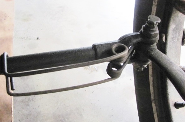

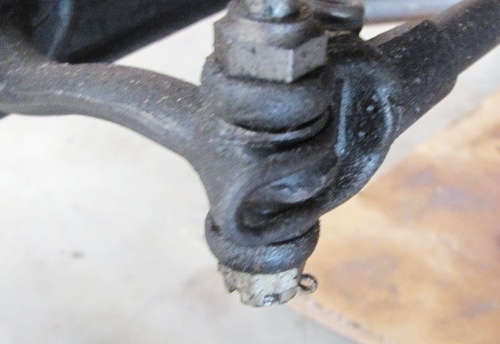

My truck came with virtually no cotter pins on the castle nuts so I've been going through adding them everywhere they belong. My steering works fine with no binding but the bolt through the castle nut on the tie rod end will not budge. I've soaked it for 2 weeks with PB Blaster and even used an impact hammer to see if it would move, but it will not. So before I put the heat to it, I was wondering if i'm missing something? Its the first bolt on the truck I have not been able to break free. Thanks in advance for comments!

The tie rod bolt screws into the yoke, the nut is a lock nut. Remove the nut first then unscrew the bolt.

Use a 6 point socket so it will not slip on the nut and a 2' handle. Then if it still will not budge, take a hammer and hit the handle like an impound. It should either loosen the nut or break off the bolt. If that doesn't work, Take a long pipe and slip over the handle. Then you can get the bolt out. You will then need a new bolt. Another idea would be to take a center punch and put a dimple right in the center of the bolt end and then drill out the bolt.

New tie rod bolts come with new nuts, so you can get rough with that one. Have someone back the nut with a heavy dolly and use a cold chisel on the opposite side. You can do that on three of the sides You will be upsetting any rust bond, and expanding the nut a little. If that does not loosen it, keep on with the chisel and the nut will split.

Once you get it all rebuilt, throw away the anti-shimmy spring that's currently on that tie rod end.

Jerry VanOoteghem wrote:
Tue Mar 19, 2024 1:24 pm
Jerry is correct
If left in place for a while that hardened spring accessory will indeed wear its imprint on the knuckle of the spindle arm :o

There is a simple tool you can buy called a nut splitter that makes removing rust on nuts a cinch. They are available in different sizes. I used a cold chisel to split nuts on exhaust manifolds on my antique tractors until I got these tools. Be careful to not mess up the threads on the bolt as you could damage the threads inside the yoke as well. Perhaps a thread chaser could be used after you get the nut off to aid in removing the bolt. Good luck!

Received my parts and rebuilt both sides of the tie rod ends and removed the anti shimming springs that were cutting into the fittings. Thanks all for the suggestions. I also find that my tie rod has about a 1/2” bend so I’m debating with myself if it’s worth messing with? The bend is opposite the front axel and I have a spring compressor that would make it easy pull the rod straight using the front axel as a brace. I would support both ends with some wood blocks. So is 1/2” worth fixing or would I run the risk of breaking something?
