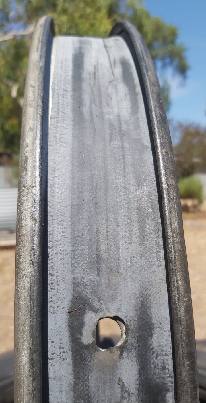

Found these two photos.
This shows a rim liner made from the OD of a 14" inner tube.
When fitting this hard old Olympic tyre I used 3 clamps, just because I could.
Notice the beads are not yet levered on past the clamps. Tyre lube even helps th tyre slide on the levers when working around the rim
