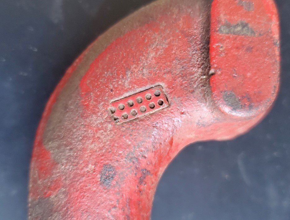

What are the rectangle and dimpled inclusions on this intake manifold from or for?
Re: Casting Marks on Intake Manifold
Posted: Sun Mar 24, 2024 10:22 am
by t-time
casting chaplets used to stabilize the core.
