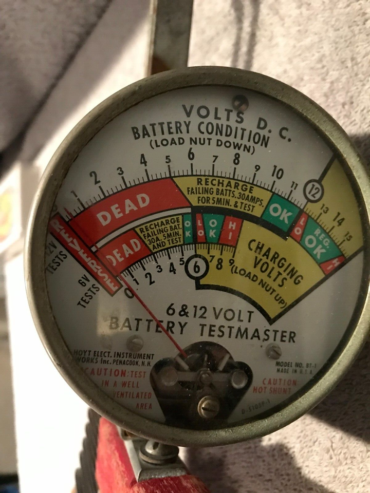

				Does anybody have instructions to this tester.  I would like a copy.

				From the looks of it I suspect you just stick one probe on one terminal and the other one on the other terminal.Then read the meter.  Looks like it has a bit of adjustability for various sizes of batteries. No doubt the squiggly things will produce quite a bit of heat so I'd be keeping my fingers clear! And as Pat said...beware of explosive fumes. This looks a bit dangerous to me.

				Side note...I'm also guessing the big dark handled probe is for the positive terminal but of course it's a 50/50 shot!

				It's for checking the condition of batteries and of charging systems.  It is missing a probe..
The upper scale is for 12 volt and  lower for 6 volt. There should be a button to push to put current through the resistance (the wavy material).
With engine off, connect the probes to the battery posts.  Then push button.  It will indicate the condition of the battery.  If needle is backwards, reverse the probes.
To check charging system, start engine, connect probes but don't push button.  The needle will indicate the condition of the charging system.

With the absence of a "button", it appears to load test only.
However a simple, temporary bypass wire to connect around the resistor would give you the 2 missing functions of a non load battery voltage test & a running charging system check.

				I missed seeing the"load  nut " printing on the face of the meter. Instead of pushing a button, apparently a nut is turned to engage and disengage the load..
