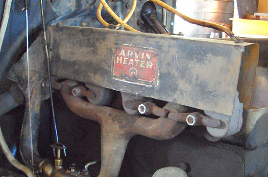

The plus on the exhaust manifold is that it not prone to warp but check the threads
The ARVIN on eBay
https://www.ebay.com/itm/134990497521?i ... R8ip1bjQYw
https://www.ebay.com/itm/256283378615?i ... R9Sn5LjQYw

https://www.mtfca.com/phpBB3/download/f ... &mode=view
The heater label on the heater that TRDxB2 shows is not correct but one I copied and added on that heater. I'm sorry if I have added to the confussion. That was my best guess at the time.
