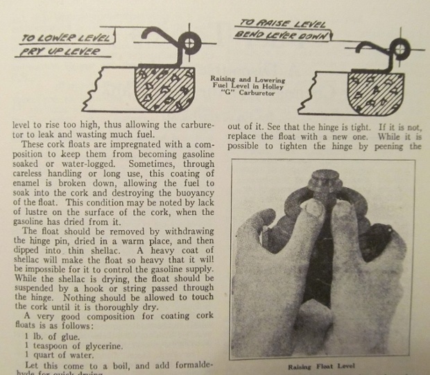

Here's some detail of the Holley G float setting and gage.
