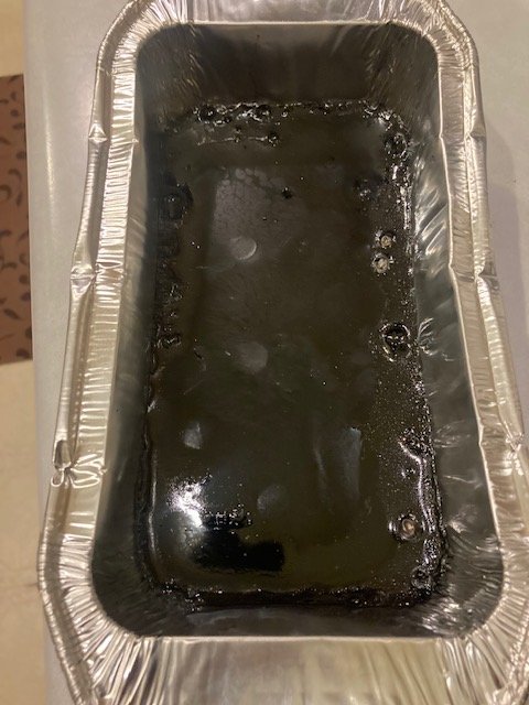

New capacitor , soldered leads , and re-potted with hot tar
