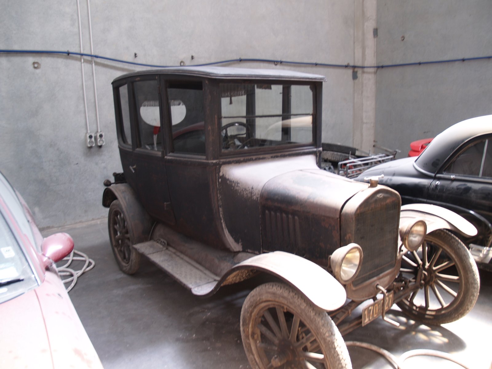

Hi Jay, the picture below is a late 23 /early 24 original 'time warp' Canadian built center door. No cowl lights at all and electric tail lights.
I have many pictures of details if they are of use to you.
Kind regards
Adrian

Yes, that Centerdoor is the same car I posted the links to from the 2012 forum where you posted some photos about the car. I don’t know if Jay is interested in additional photos at this time, but I know I am.
So far, I know of only 2 Model Ts that continued the earlier 1922 style closed car body sytle but were mated to the high radiator & high cowl that was typical of the 1924 model cars. One is the Centerdoor that you kindly posted photos of. The other is a Suicide door coupe with the high cowl, high radiator and high hood and a long known history. One photo of that coupe is shown at: https://www.mtfca.com/discus/messages/8 ... 1261044115 it is the second coupe photo at that location and is shown parked part way out of the garage.
If only those cars could talk….. I wonder if they were a one off or if 100s or 1000s of them were produced by Ford of Canada. One theory of mine (that would be a guess) is the body had been ordered but not completed or delivered. And in the meantime, Ford of Canada had switched to the high cowl & high radiator assembly lines. And so the last body or few bodes still remaining to be completed were fitted with the high cowl to mate with the current production line high radiator, valance below the radiator, front fenders with the bent over section to “flow” into the radiator valance etc. Well, I think that is more plausible than the aliens ordered a special body for their T. But it maybe just as far fetched.

If you post some photos of the Centerdoor and ask some more questions folks can hopefully help you answer some of those questions. If you look at the 2nd photo Adrian posted above you can see that car appears to have the window latches / small lever that fits in a slotted track to hold the door windows open.
