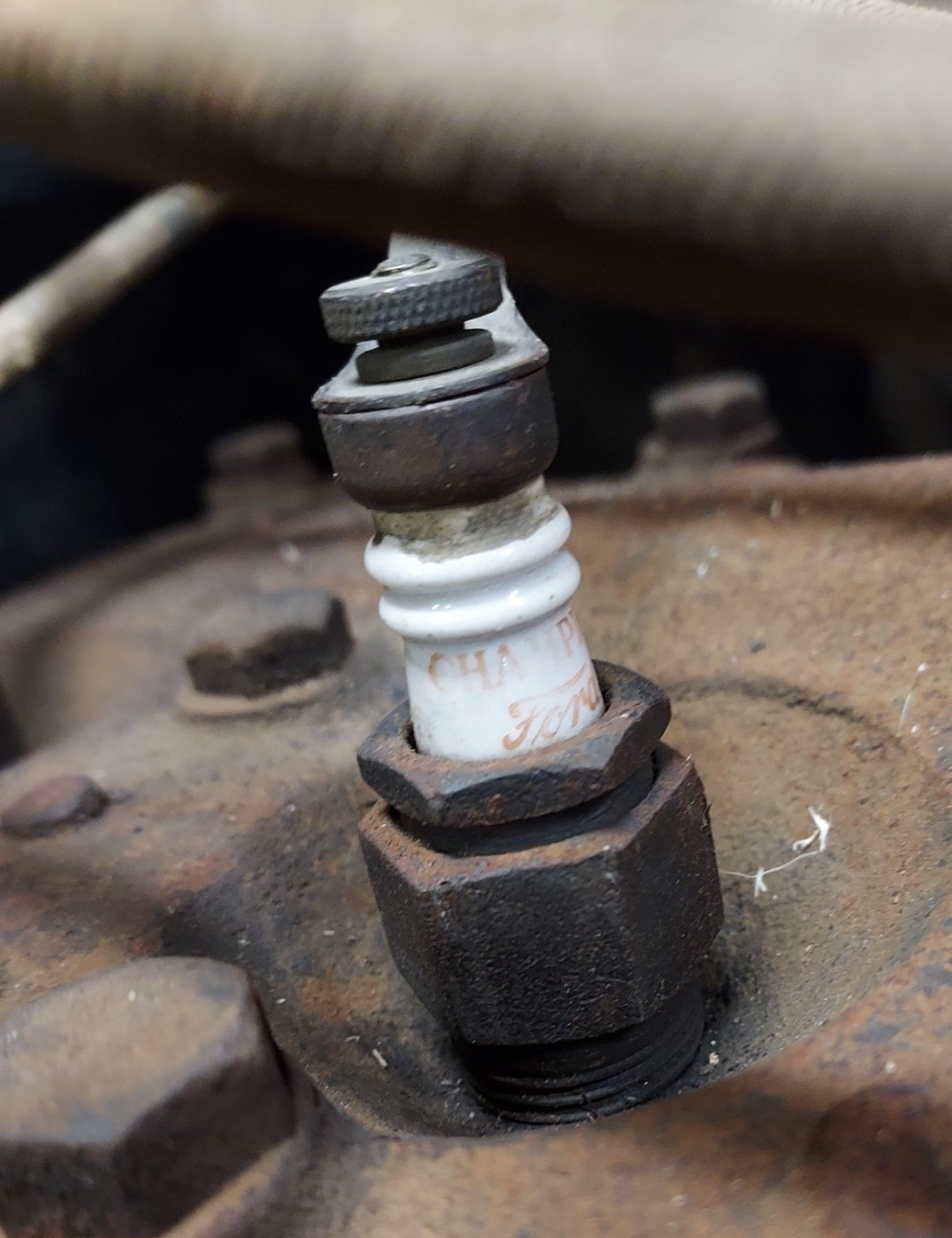

				by Humblej
				My unrestored 1924 runs with its original to the car Ford script Champion plugs.
				Re: Take-Apart Spark plugs
				Posted: Mon Apr 29, 2024 11:01 am
				by Steve Jelf
				Jeff, that is certainly the right style of plug for 1924. But how do you know it has never been replaced?
