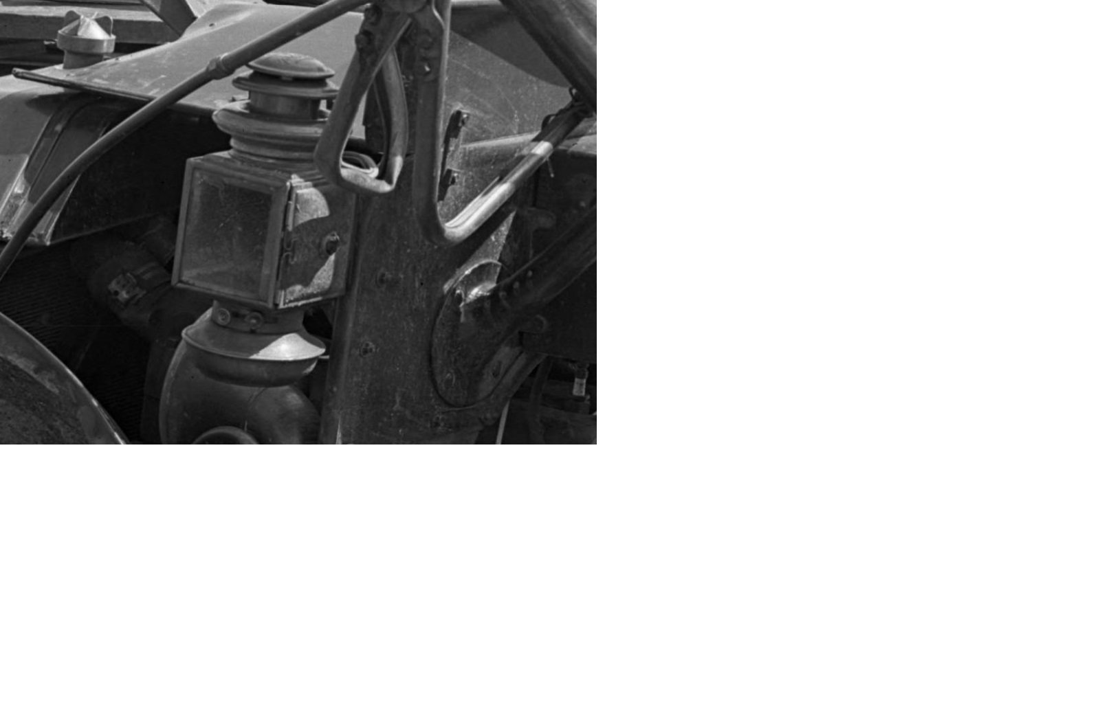

George, these photos were taken in 1913 of a Tornado-damaged '09 or '10. Look at the nuts on the dash. They are square for the windshield but hex for the lamp brackets.
Sorry, these are not great photos but what I had available.
