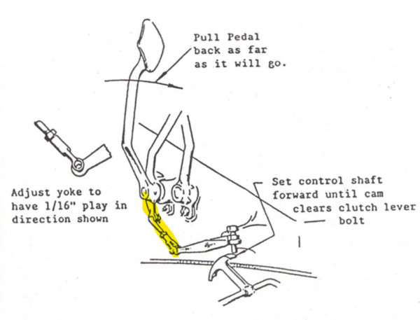

Dave,Dave Loving wrote: ↑Wed May 08, 2024 6:52 pmFreshly rebuilt Transmission, when the low speed pedal is depressed it sticks.
I initially had this issue when I first adjusted the low speed linkage on two engines that I rebuilt. It was because the linkage at that stage was being allowed to go over center and that essentially "locked" the pedal in the low speed position. This can happen when the linkage and arm on the low speed pedal are in a straight line. The two pieces are shown in yellow on the sketch.
I was able to get the linkage properly adjusted so that it would not go over center. You may want to try a combination of adjusting the freeplay a bit more, plus the band adjustment to see if you can chase this issue out. If not you may need to make a longer link as suggested in another post.
