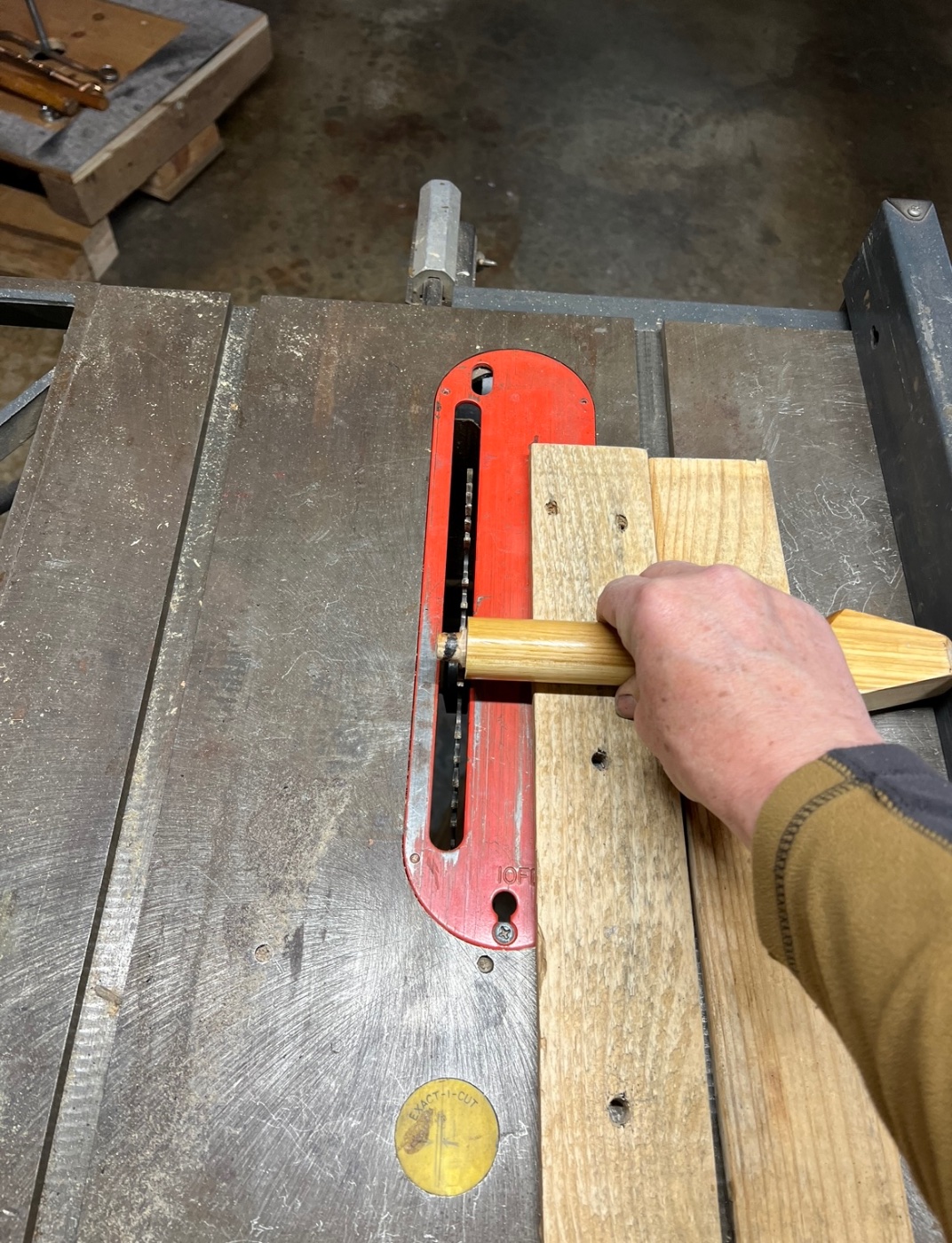

I ended up ordering three new spokes, ensuring they were correct for my fellows, then I trimmed all of the spokes by ~1/32”.
Trimming spokes.
Trimming spokes.
They were still longer than the original spokes and were a compressed fit.
