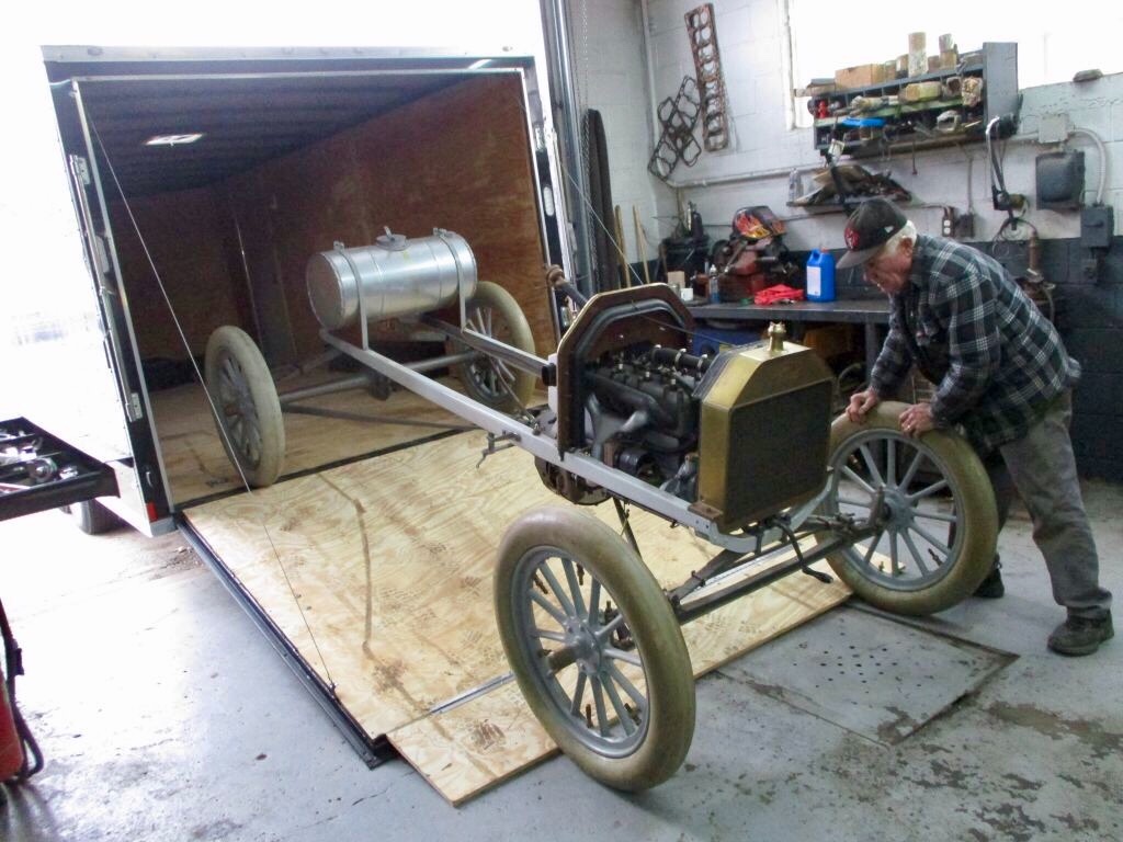

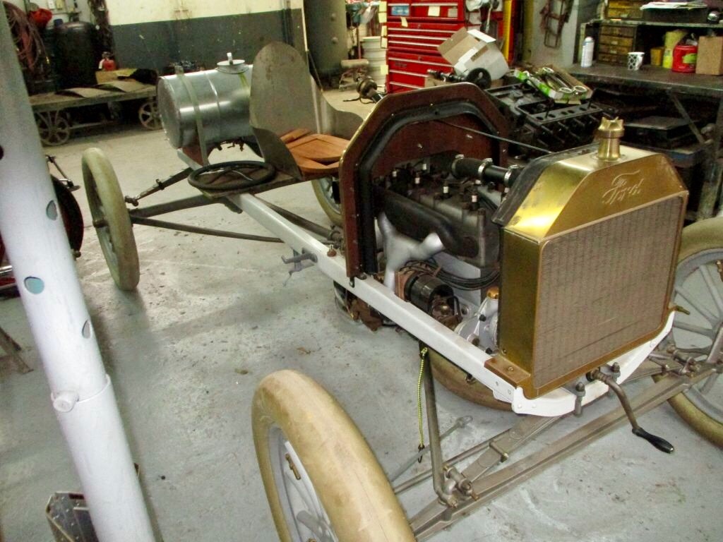

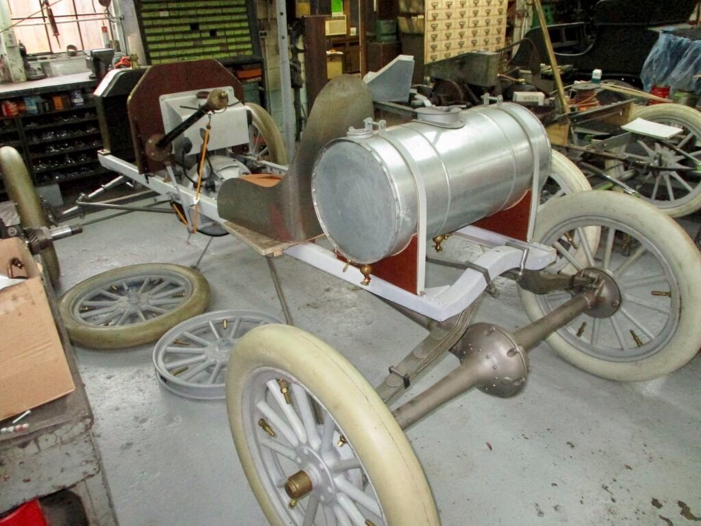

Just received these from Peter Fawcett's shop. They are beginning to fashion the seats, then putting together other remaining bits and pieces. Meanwhile, one of the Ford Special racers may have been sold by FMC back in 1912.

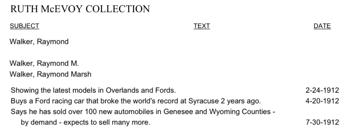

Meanwhile, I've found two 1912 records of a Batavia N.Y. Ford (and other makes) dealer buying the Ford Special racer that won and placed second in races at Syracuse N.Y. in 1910.

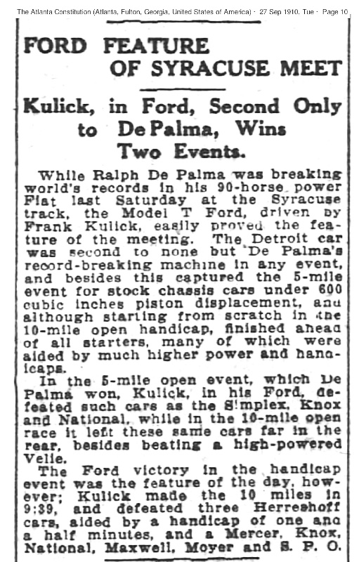

I enjoy sourcing these stories, and sometime the newspapers tie in historic events of the period with the cars we drive and rebuild. In this case, two iconic moments. First, the Ford Special winning and running in front in the 1910 N.Y.
races:

This 1912 Batavia N.Y. article mentions that Ford dealer Raymond M. Walker has purchased the same Ford racer. On the front page of th daily paper the Walker Racer article appears in?

Corroboration to the story, from a collection of local history about area residents of the time:

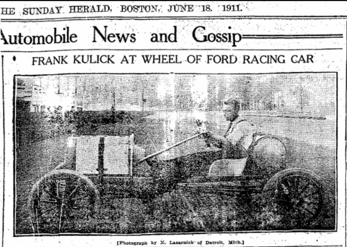

I've been trying to determine which of the Ford Special racers our motor "resided" in. I believe it's the same 300 cubic inch motor used in one of the two Fords that ran (and won) several races at the Mardi Gras Speed Carnival in New Orleans in late February 1911. It also may be the same one sold to Walker in 1912. Our motor was set up for no muffler, while the other Ford racers I've found pics of (4 or 5 of these machines existed) could be equipped with mufflers or side pipes. Because our motor was placed in a traditional Ford chassis, the fourth cylinder is actually behind the firewall, and so the exhaust manifold just has one large opening just behind the right side of the firewall. This photo shows what I believe is the same racer (engine), with a fake "tank" on the firewall hiding the 4th cylinder:

Very nice! Would love to see some detailed images of the engine, is there anything special about the drive train.
Thanks for posting

As pointed our by Hap and others in an earlier thread, there is at least one (about #162,000?) production T in the production records as racer for Kulick. Ford did race production T's in a few competitions such as the Elgin Road Race, and appeared to promote the Ford special racers as "stock chassis" racers. However, sometimes the racers specs are given. I'm still trying to find one article I've seen but evidently didnt save, where a reporter thought the racer possesed a six cylinder motor. He thought it was six cylinder because he saw plug wires going to six plugs. What he actually saw were six plug wire going to three cylinder (Bosch dual ignition mag), and the fourth cylinder was hidden because of the long motor protruding rearward beyond the firewall (false tank in the newspaper pic above).
