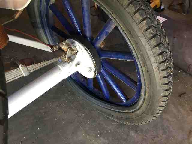

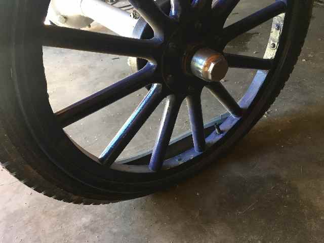

Easy enough, Bill even agreed to help prep the car for it's first drive. So off we went to my house and we added fuel. Wow, cool new waterfall... er: "fuel fall" as the NH overflows. Experimenting eventually led to replacing the brass float. A quick adjustment and tighten spark wires on the DU4 mag and we are ready to give it a try. Second dumb thing: The right rear tire is a little low, but since my compressor has just blown a hose, I can drive ok on a low tire.

Hey, why is that car leaning to the right?
See dumb thing Second above!
