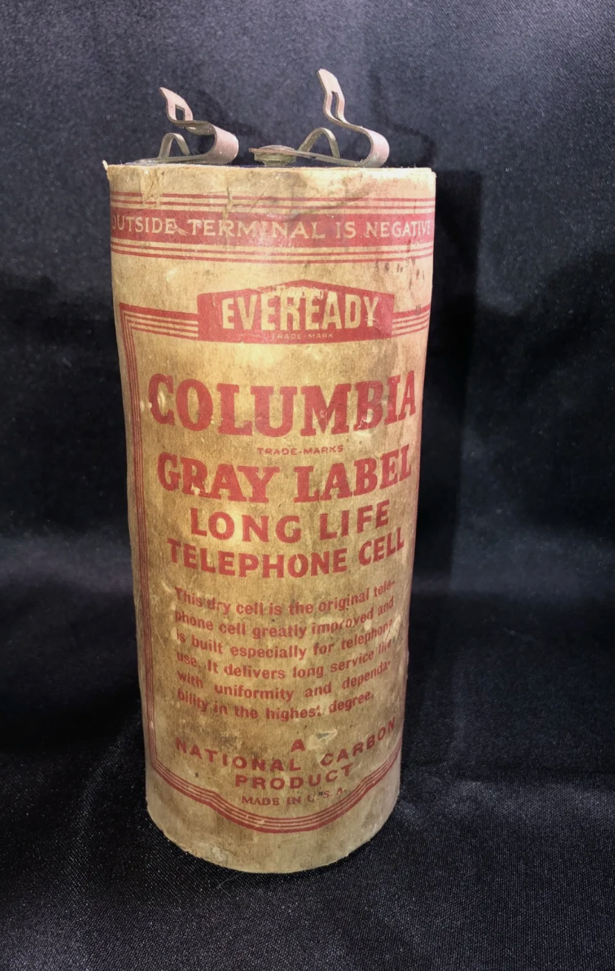

by Steve Jelf
These were used in many a Model T. They were plentiful and cheap. How plentiful were they? Nearly every phone used two of them. Now they are scarce and costly.
