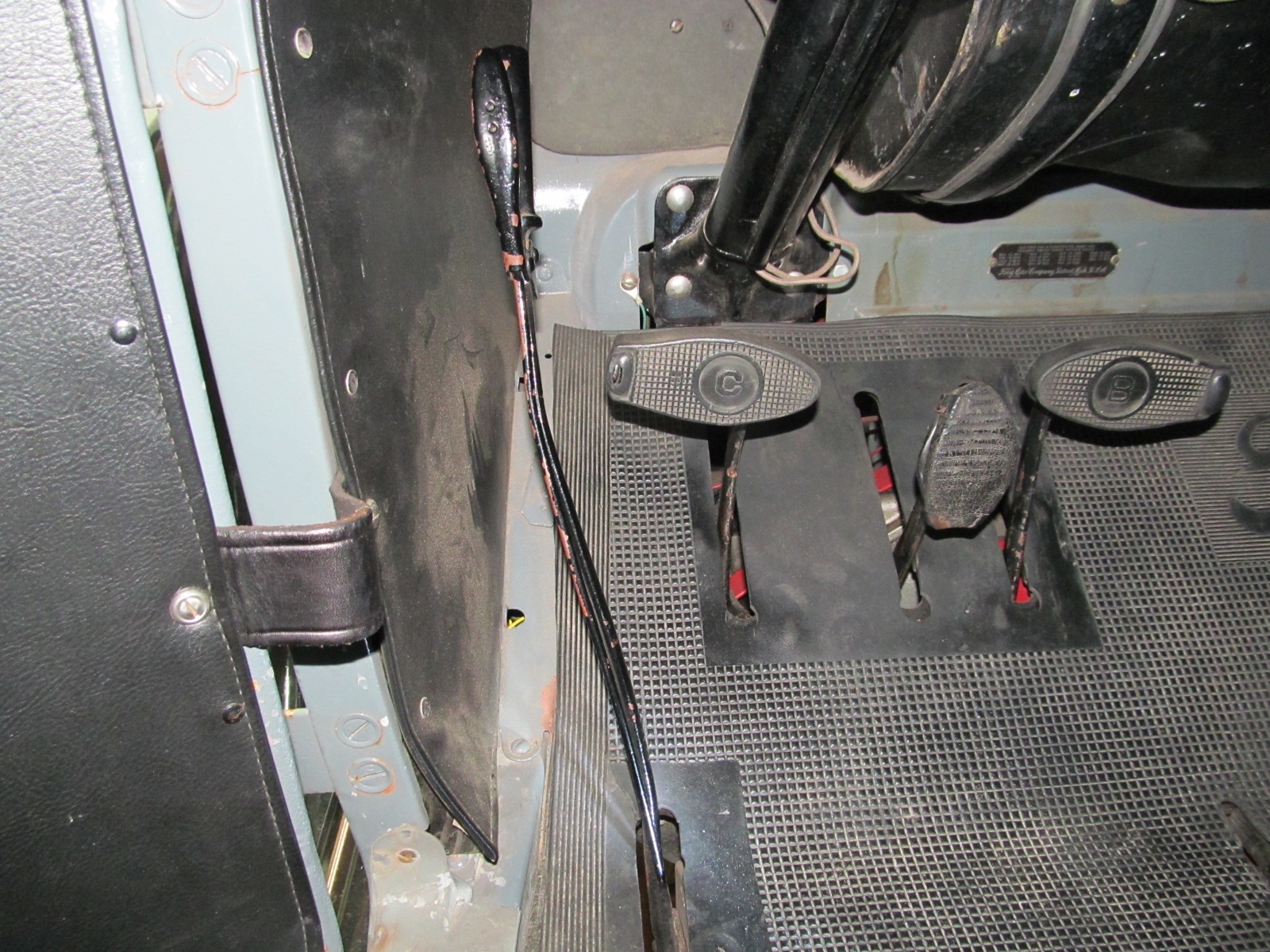

Owners could 're-shape' the hand brake if needed, good Ford steel easy to bend cold.
Original '26-'27 show different patterns, what works for you is what counts :D
The open cars have lots of cut-away at the dash panel for the hand lever to keep your fingers from getting mashed.

by RGould1910
Thanks for the help. Here's the handbrake test installed with long pins thru thru the flipper to hold it in place. The spacing/fit is good but I need to set the pan in the car with the hogdhead and pedals to check for clearance. Sorry for the poor photos.
