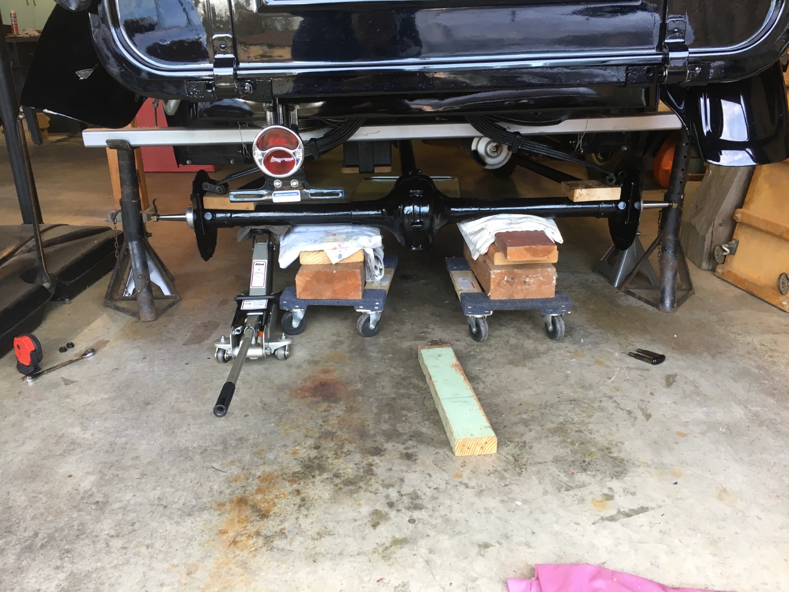

I use a couple of HF furniture dolly’s so the assembly will pull forward easily.
Then I use a piece of rope to hold up the end of the driveshaft and a heavy gauge wire hook to guide the u-joint into place as I pull on the shaft. I’ve also had a helper slowly push from the differential while I guide the U-joint.
I then use the dollys and blocks to keep the axle at the correct height while reattaching the spring. (Note 2x4 blocks between axle and spring eyes.)

I do it myself. I use three jack stands sitting on car dollys as illustrated in previous post. Two under ear axle and one on the drive shaft tube about 12” rearward of the radius rod connecting point by the u joint. That way I can control all of the movement fairly easily. Works pretty good. Getting the line up of the u hoist the the 4th main can be challenging. Good luck!
