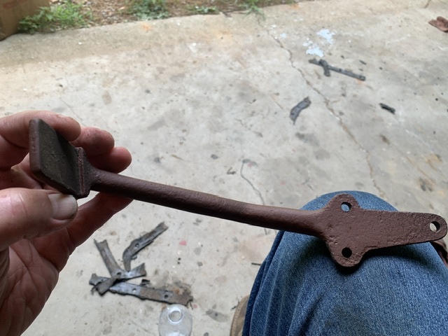

Here is one that came with a 13 Touring I parted out a few years ago. I thought Touring were long and Roadster were short.
