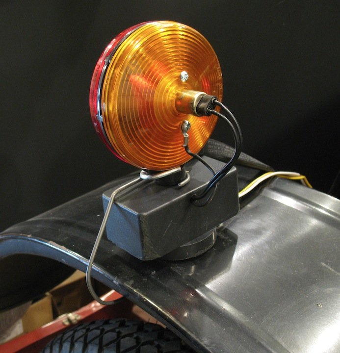

Most car batteries are twelve volt, but that doesn't mean you can't get six volt. The same goes for LED bulbs. I bought some HF trailer lights and converted them to six volt LED for my runabout. They ride in a box in the trunk until I need to use them. LED bulbs are directional, so I did have to alter the lights to aim the bulbs rearwards.
A welding rod hook and a rubber bungee keep the light from bouncing off.
