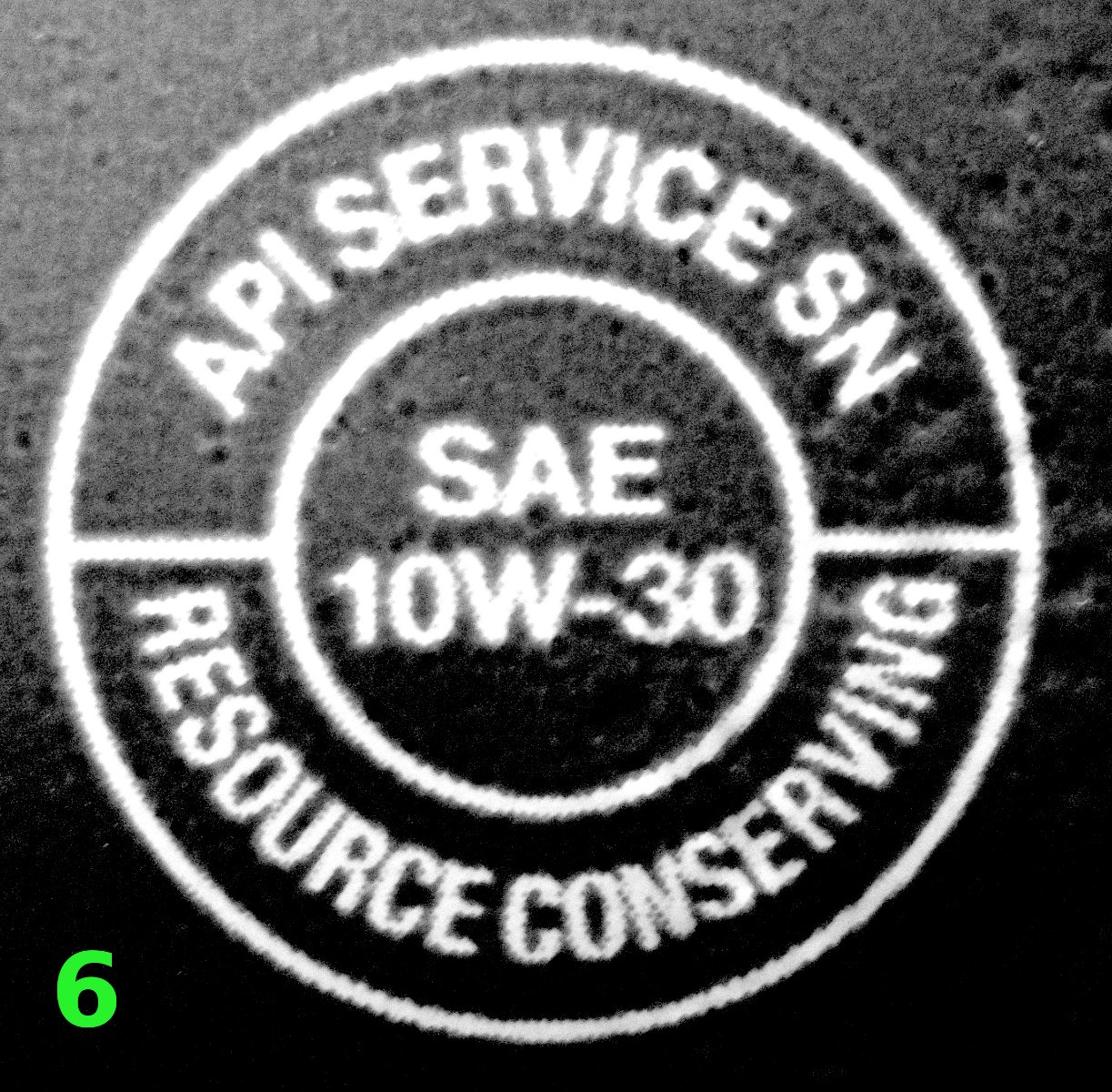

				Let's go shopping. Just so we'll be comparing apples to apples, we'll restrict our choices to conventional 10W-30 motor oils. Here's are some we find at Walmart.
1 quart Chevron....................$4.42
1 quart Pennzoil....................$4.68
1 quart Quaker State.............$4.24
1 quart Valvoline...................$4.47
1 quart Super Tech................$2.78
These all have the API certification mark (Starburst) on the container. https://agriculture.mo.gov/weights/fuel ... icants.pdf
Which one is best?
Why is it better than the others?
Are any of them unacceptable? Why?
				Re: Best oil, I’m almost afraid to ask...

				As long as the oil meets the standard, I think you are fine.
I found some interesting info on house brands here: https://www.bobistheoilguy.com/forums/u ... Super_Tech_
I've always suspected the reason for the notable cost difference has to do with big advertising budgets or the lack thereof. Ray H in So Cal seems to agree:
"The only problem with SuperTech motor oil is that WalMart doesn't promote "image" by packaging it in macho designer bottles with hex-head caps, scent the product with extract of fruity candy, or spend lavishly on TV ads touting their motor oils' use at Le Mans, Indianapolis, the Pike's Peak Hill Climb, the annual Soap Box Derby, and as original factory lube for Schuco clockwork car repros, Cracker Jacks clicker toys, etc."
So far nobody has explained why an oil that meets the API standards is inferior to other oils which meet the API standards. Lots of folks imply that, but I'm waiting to see evidence that backs up the implication. I'm perfectly willing to buy one of the big name brands when empirical evidence persuades me of its superiority.
				Posted: Wed Jun 12, 2019 10:43 pm
				by Steve Jelf
Based on the information provided by the API, which of these seven is best? Why? Is there any we shouldn't use? Why? If the API donut isn't enough, what criteria should we use in choosing an oil?
				Posted: Thu Jun 13, 2019 12:35 am
				by Scott_Conger
				Steve
The API donut tells you which classification the oil within meets. All of the ones you posted are SN or SN plus. Based on those posted, the SN Plus is the "latest" in rated oil. Considering the extra oxidation protection, etc., that SN and SN Plus offers, I personally would be fine using either.
What folks don't realize when they say they paid "$1.99" for their oil and that it is "better than oil back in the day", they are likely purchasing severely under-rated oil, which is available in many places. Yes, it is probably better than oil in the 1920's, but perhaps only barely (and maybe not at all). All oil is NOT created the same, is not categorized the same, and usually the lack of quality/superiority is reflected in the price.
One final link to show the differences in ratings:
http://www.pqiamerica.com/apiserviceclass.htm
Note: just because a classification is listed "obsolete" does not mean oil is no longer produced to this classification...it definitely is still produced.
I am as big of a bargain hunter as there is. I just recognize that because something is cheap, that doesn't mean it's a good deal or even a good idea. However, I doubt this will sway many who are simply determined to spend as little as possible on their oil. The bottom line, is they are buying on emotion, with little regard of facts.

				Posted: Thu Jun 13, 2019 1:18 am
				by Steve Jelf
				Yes, I read that page when I looked at the previous link. Based on the donut info, I surmise that all the oils I checked would be OK, and that #2, #3, and #7 (SN PLUS) would be the best. Here are the containers bearing the seven donuts pictured above.
				Posted: Thu Jun 13, 2019 1:22 am
				by Steve Jelf
I meant to include just conventional oils, but I see that this one is synthetic.
