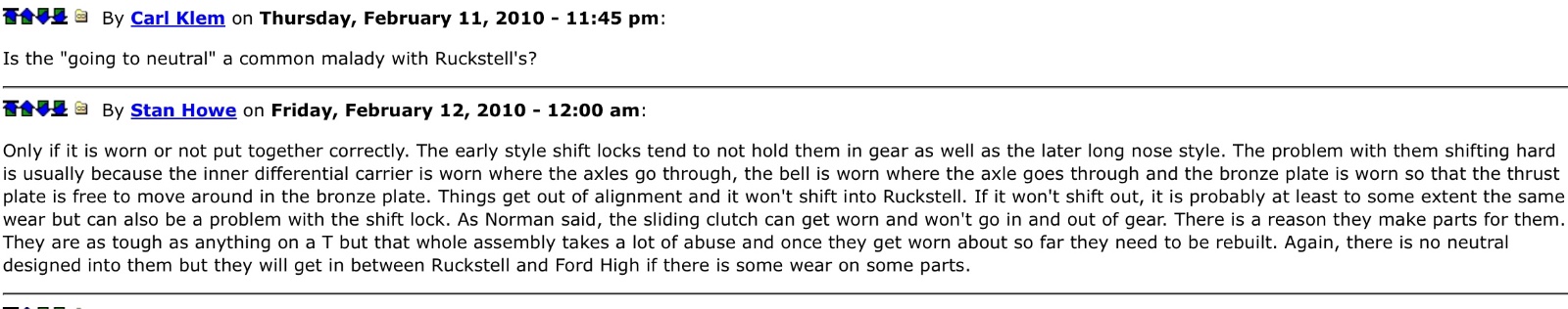

ThreePedalTapDancer wrote:
Thu Jul 25, 2024 6:44 pm
The late Stan Howe is here again to address this question.

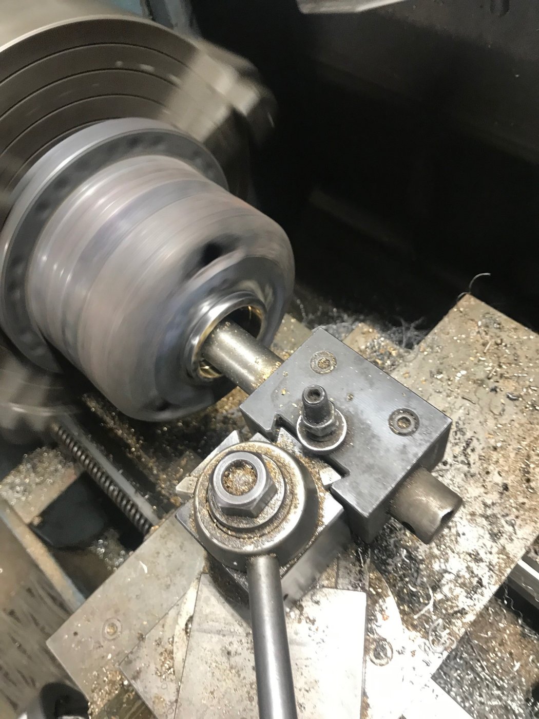

Stan makes the statement that the bell and the differential carrier is worn here the axle goes thru causing alignment issue and hard shifting.
So I think it was Erik Barrett that posted pix on social media showing him brazing up the place(s) where the axle goes thru and then machining it. I think he even mentioned that often times that area when cooled after the brazing shrinks where most of the brazing is machined out afterwards. I looked in my Ruckstell book for that measurement then (-and just now) and I don't see that bore measurement. Am I missing it??
Ruckstell Housing Repair 01.jpg (48.69 KiB) Viewed 4438 times
