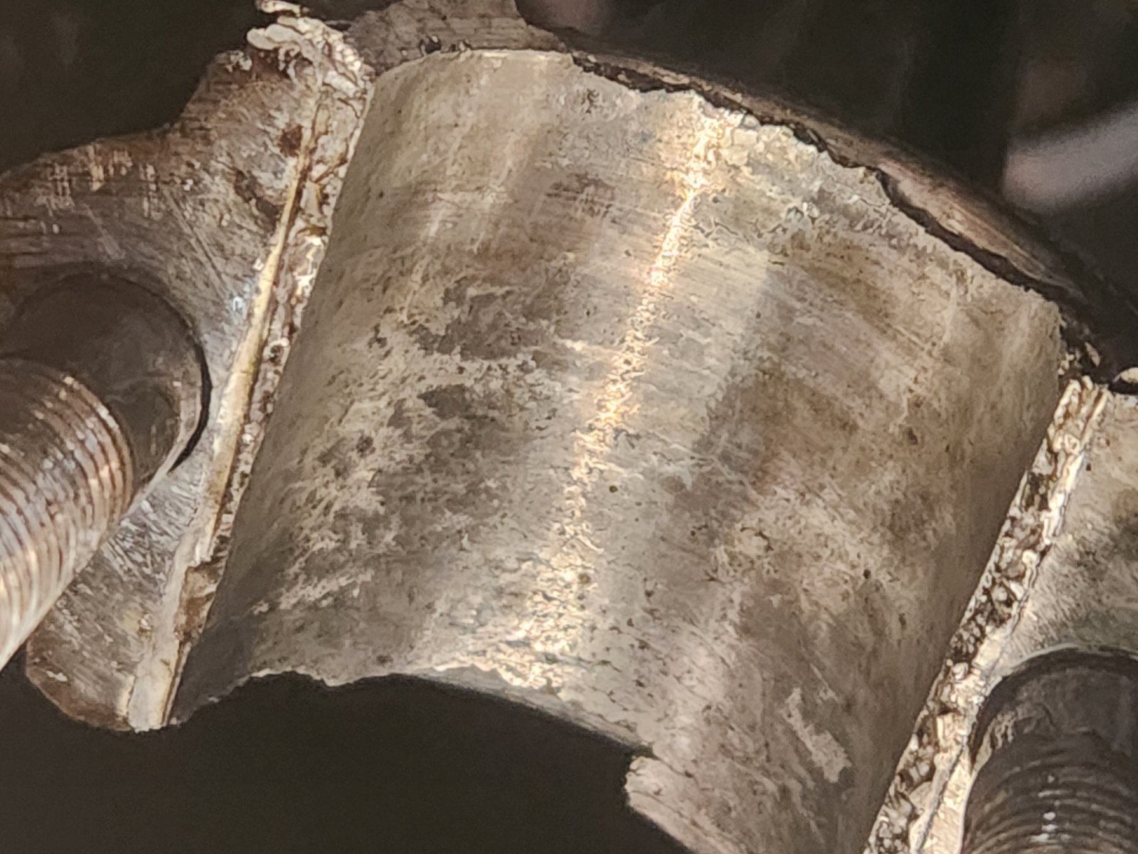

Ok so I took the inspection cover off, there were a few small chunks of Babbit in the dips (4 dip pan). I took the front rod cap off and it looked OK but the babbit in the rod itself was crumbling on the edges (see photographs), luckily the journal looks to be in good shape although I haven't measured for taper or out of round. I must also add that I fitted a mag post oiler and I try and run with a little more oil because of the hilly country. This car is also a daily driver and I put probably 300 miles on it this summer so I'm amazed that it held for so long. (maybe 45mph down the Truckee River was a little excessive but I'm 19 what can you expect lol)
Unfortunately, I'll have to wait until I trailer it out to Colorado where I have a proper garage to take the rods out and re-babbit them.

Well, that does not look so good. You've at least got rod troubles. Hopefully, not mains too.

by Joe Reid
How do the wrist pins feel? How loose was the rod on the crankshaft?
Re: Sudden Rod Knock
Posted: Sat Aug 03, 2024 5:43 pm
by JohnK
Joe,
The rod wasn't as loose as I expected it to be but it did have a tiny (could barely feel it) amount of vertical play and a nonzero amount of end play. also, the wrist pins seemed tight but the engine has .060 positions so I wouldn't be surprised if the little end is generally tighter. I think I'll just put it back together so I can get it onto the trailer and really tear into it in CO.
