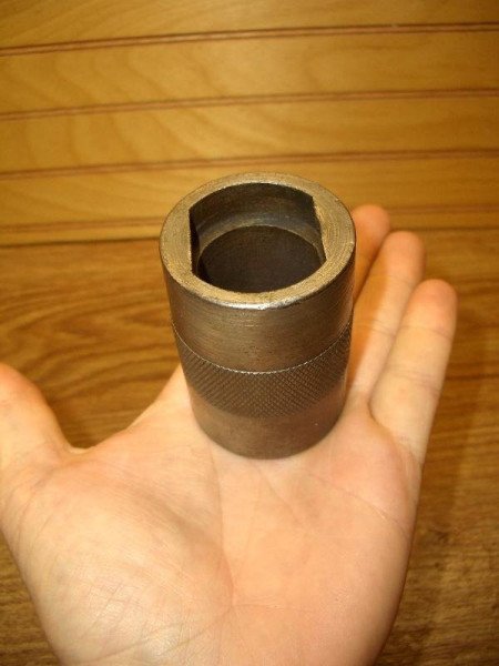

I like the Snap-On 36F socket.
Cam Nut Socket.jpg (40.99 KiB) Viewed 3593 times
Not my socket, don't have it in front of me to take a photo. The socket is a lot bigger than you think. If anyone has a Snap-On 35F Fan Shaft socket they would like to part with, please let me know.
