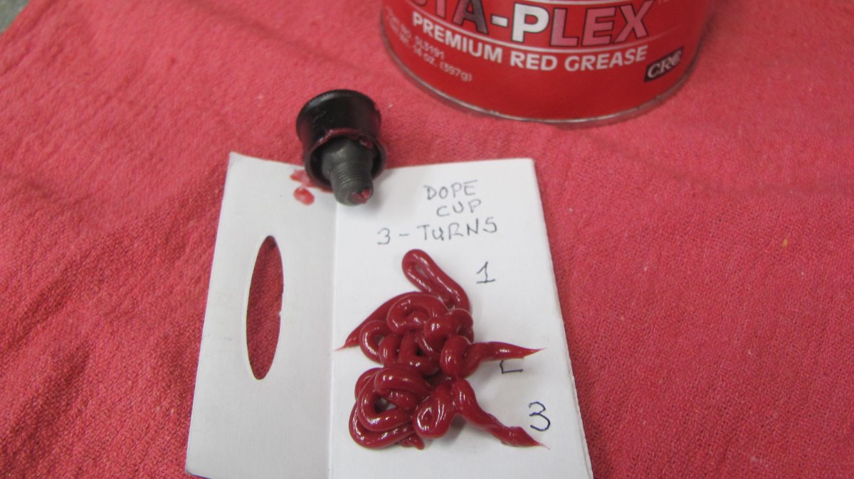

For a side-by-side of Dope Cup fills and complete twists until empty......to individual pumps of the grease gun out a Zerk, you can see my photos.
Gives you some insight on how many pumps you need with a Zerk to meet the volume of grease the Ford dope cup gives ;)

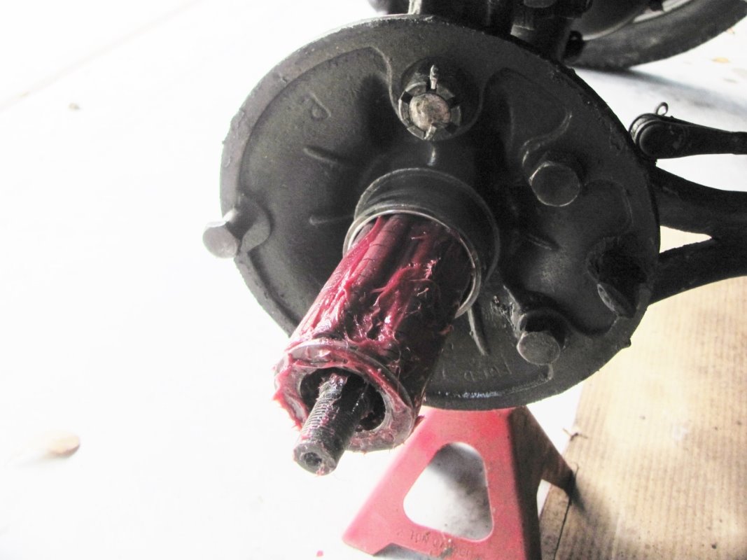

Experience for me, and with modern inner and outer seals, is the red grease that you pack there when removing, cleaning, and inspection of those outer Hyatt roller bearings........after running for 3000-5000 miles...... it just liquefies and turns runny and dark with age and who knows what, but isn't doing its thing.
Here is my rear Hyatt, with the normal every 500 miles of filling and turning the dope cup several times.....still was looking lube poor :?
So, pulled and cleaned, inspected rollers and sleeve and then added fresh red grease, just like before. Re-install. The Ford likes grease and oil :D
