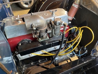

I am having some carb backfiring and wanted to see if anyone had insights before I start “trying” things to fix it.
Here is what I have: 26 engine,rajo BB head, Winfield SR down draft, AB distributor. Fuel is hand pump, set to 1.5 psi with an hidden regulator. Engine was built in the 70s, I rebuilt the Winfield and distributor this winter getting it back on the road. It’s timed properly, starts easy and idles nice but every once and awhile it will back fire through the carb. It might be one or two fires or it’s a series of them. Took it out for a long ride this weekend and it seemed to back fire when:
- if I forgot to pump the fuel and recharge the pressure while driving. Happened once and once I caught it, it stopped.
-going too fast in ford low
-40-45ish mph in ford high which is pushing it
- a few times it was just random
Once I was in ruckstell high doing 55+ (running buffalos), car is set up for high speed, it’s very happy going fast it seems and there was no back firing from the carb at high speeds.
My initial thoughts are the carb is running lean, maybe it needs more fuel psi 2-3 psi and a reset on the Winfield maybe?
Open to suggestions before I start making changes. Thanks!

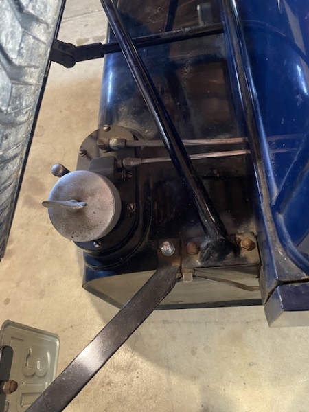

Valid point, yes I should be “good” on fuel quality. It’s a modified period tank (late teens/20s, if anyone knows the year/brand I would love to know) tank that is below the spare. The tanks was cleaned and recon inside. New filter and I have a gauge after filter and regulator to confirm pressure matches my dash gauge too. Running fresh ethanol free 89 octane filled in June maybe. I could double check the pressure on the gauge after the filter to confirm none of the recon coating has flaked off and clogged the filter. Good point!

I write this information for what it may be worth in hopes it may help you resolve your issue. By the way, I live in Mechanicsburg, PA. I had exact issue of backfiring, sputtering, etc. on throttle acceleration with my Model T speedster. My car runs the earlier Type 31 Rajo crossflow head. Same type head Noel Bullock used to win the Pikes Peak race back in the day. I run a Winfield S, size C carburetor and high-tension magneto. My car has the same style stubby intake manifold as yours. Anyhow, I resolved this backfiring issue by using a heat riser from the exhaust header to the carburetor via overtop the valve cover. It worked for me.
