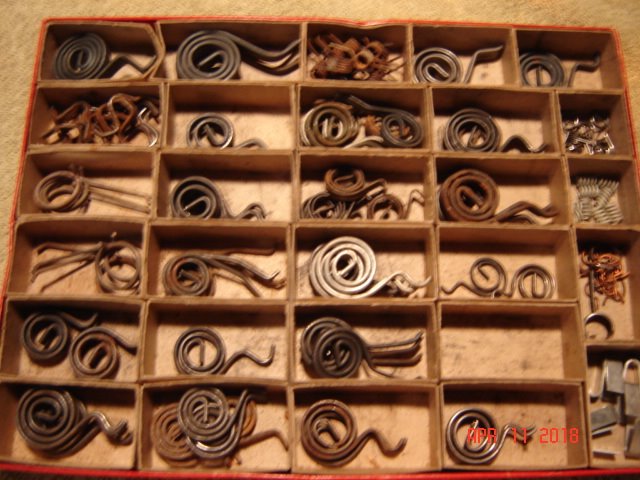

I have found that a spring for 1939- 46 Chrysler products is a perfect replacement for the 1914 Model T door latch.
