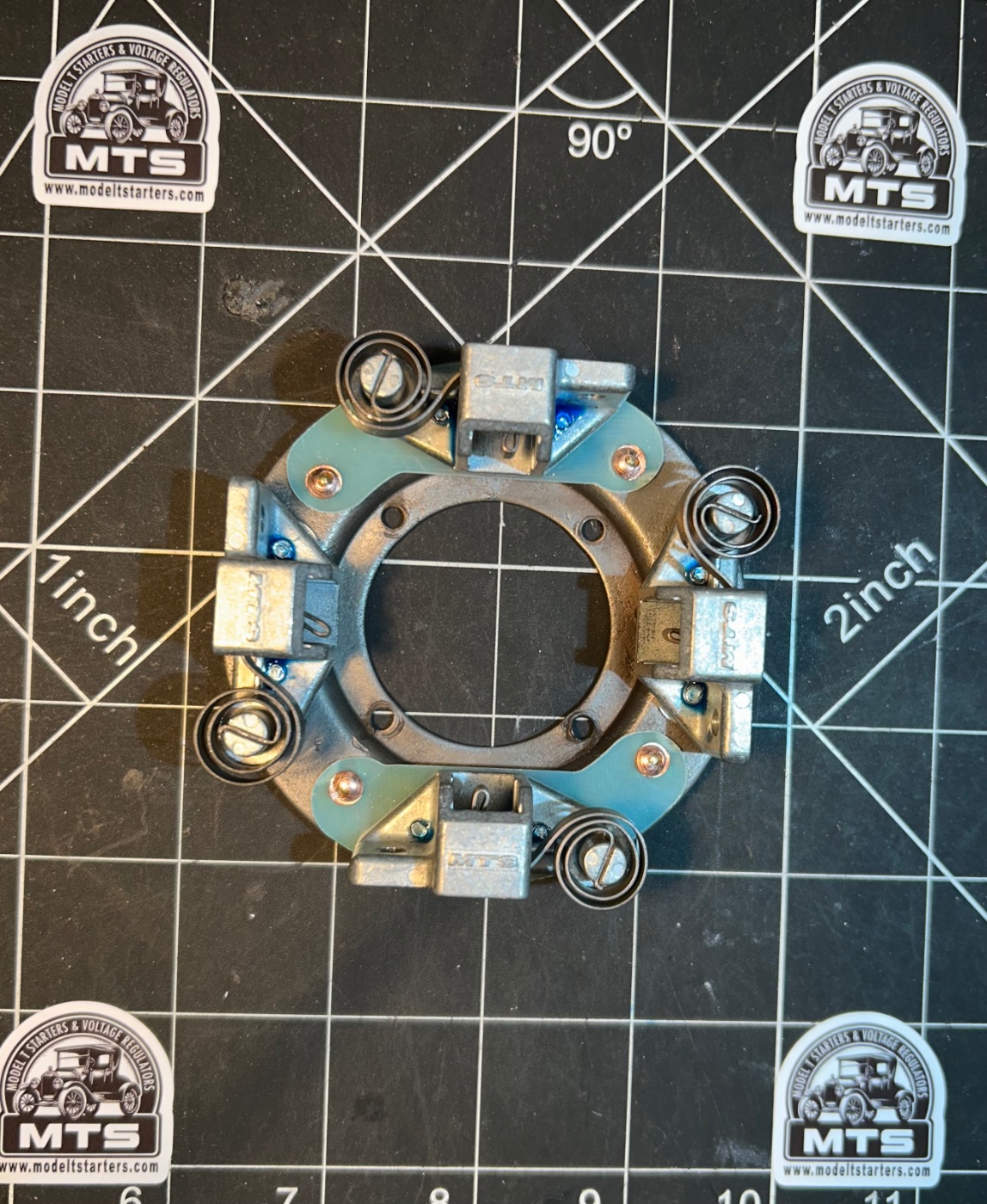

I started this journey in January of this year to create what does not exist. As you all probably know by now, I'm an expert at rebuilding starters and generators having done literally 100's of them at this point.. I often found myself cursing the quality or unavailability of certain rebuild parts for these units.
My first goal is to reproduce all parts necessary to rebuild starter & generator brush holders with ALL NEW components at the highest quality possible. 10 months later and I'm almost done with this first phase. I had no idea at the time just how much work it would take to accomplish this goal. But I persevered and overcame all the obstacles, and there were many. I'm an accomplished engineer and am no stranger to creating engineering drawings and product specifications.
Those are one thing. Getting specialized vendors to produce high-quality, usable parts from them is another thing entirely, sometimes having to start from scratch with a new fabricator. It's not sexy stuff. In fact you can't even see the parts I'm producing for your car. But all cars produced from 1919 to 1927 (and many others) need these parts to keep running, both now and in the future. Somebody had to do it. I'm doing it....
Im creating rebuild kits to refurbish starters and generators with all new parts. Everything needed to rebuild these units. I even sourced 2ml vials of Loctite (have you looked at your dried up Loctite bottle lately?)
  • Brush holders molded and die cast from Zinc (not pot metal as was done in the originals)
  • Brush plate insulators laser cut from FRP that fit perfectly and are 1/32" thick
  • Brush holder backing plates laser cut 1/32" thick
  • Brush holder springs of the correct tension perfectly molded & shaped for both starters & generators
  • All the correct hardware necessary for the rebuild - rivets, screws, Loctite etc
Once implemented, these components produce these completed brush holders - again with ALL brand new parts:
Using the parts I fabricated and starting with a blank starter brush plate it took me all of 10 minutes to fully assemble what you see in the picture above. Anyone whose done this before knows it normally takes a few hours of work to clean & massage all the used parts into a useable rebuild.
All of this work will be coming soon in kit form to a vendor near you.
Up next: brushes and field coils. A good winter project. My goal is to reproduce ALL parts for these critical components, at the pinnacle of quality and lowest cost possible.
Jeff
