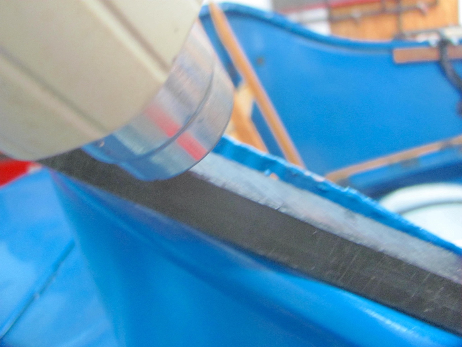

I've used the plastic strip and works good. A heat gun bends it just fine, use clamps and mount stove bolts as you go.

While ash or maple or oak wood tack strip is strong, it is hard to form, have to use steam to get the curve shape, tried that on my '26 and took a long time to get the wood pieces in place. Same with the '24 runabout.
So in my last body trims, have used the black plastic, IMO, much better than wood, is very strong, holds tacks super well, and can never split or rot. Superior in my hands.
(Left) New oak straight piece I made using neighbors router, shaped to original, Black plastic strips (Center) , new oak curved vendor wood strip (Right, original rotted Ford wood strip (on body)
Difficult in using the new straight home made, as the body isn't straight, you need curved wood, tried the curved vendor wood, but in my lack of skills fitting that pre-curved piece to the body didn't work well. The wood curves wouldn't meet with the body curves, as the body side sweeps up and then curves as it sweeps, really impossible without wet steamed wood and then clamping to try to fit.
Ended up with black plastic, sure easy with a hot air gun, no shaving, sawing, steaming, or fretting involved.
Fitting the plastic tack strip.
