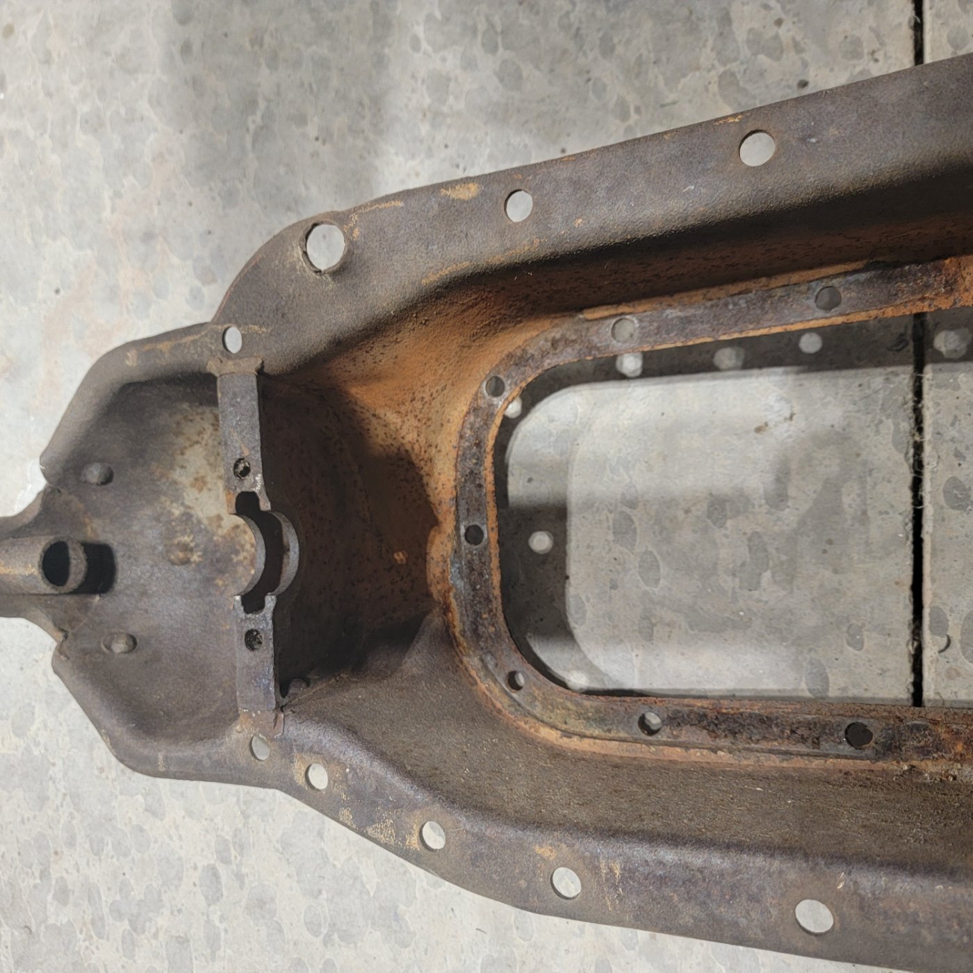

Here are two telling pictures of the pan.

That pan looks too far gone to salvage. There is one deep rust spot near the flange. By the time the rust was removed there wouldnt be anything left of it. Rust would leach out into the oil and the oil would be seeping out everywhere due to porisity.

As to the pan in question, it does look pretty far gone. Before I'd put any time or expense into it, I'd stab at some of those deep pits with an awl to see just how much steel is left. If you can poke a hole in it, there's no sense going any further.
