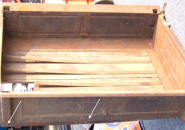

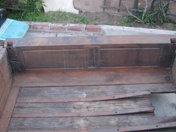

Haven't seen a plan of the wood pieces, length and width for the '25, they are different than the '26-'27, but do use the similar means of fastening metal bed strips, anchored in the saw kerf grooves of the bed boards.
Here are some photos of original wood and bed strips in a 1925 pick up bed.
25 bed copy.jpg (102.83 KiB) Viewed 2250 times
Factory part numbers showing the bed boards for the '25 are different from the '26-'27
