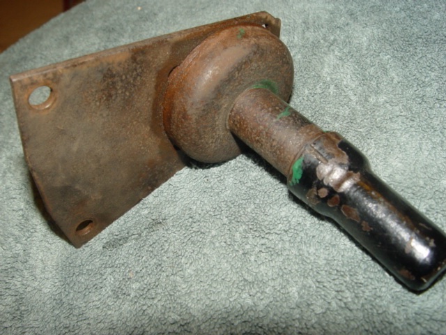

There is an extension on your repop switch, sometimes that universal fit footswitch isn't tall enough depend on your year, the 26-27 improved car uses a lower switch thru the floorboard, the earlier cars need the extension to go up thru the heel panel.
Ford original switch with extension.
