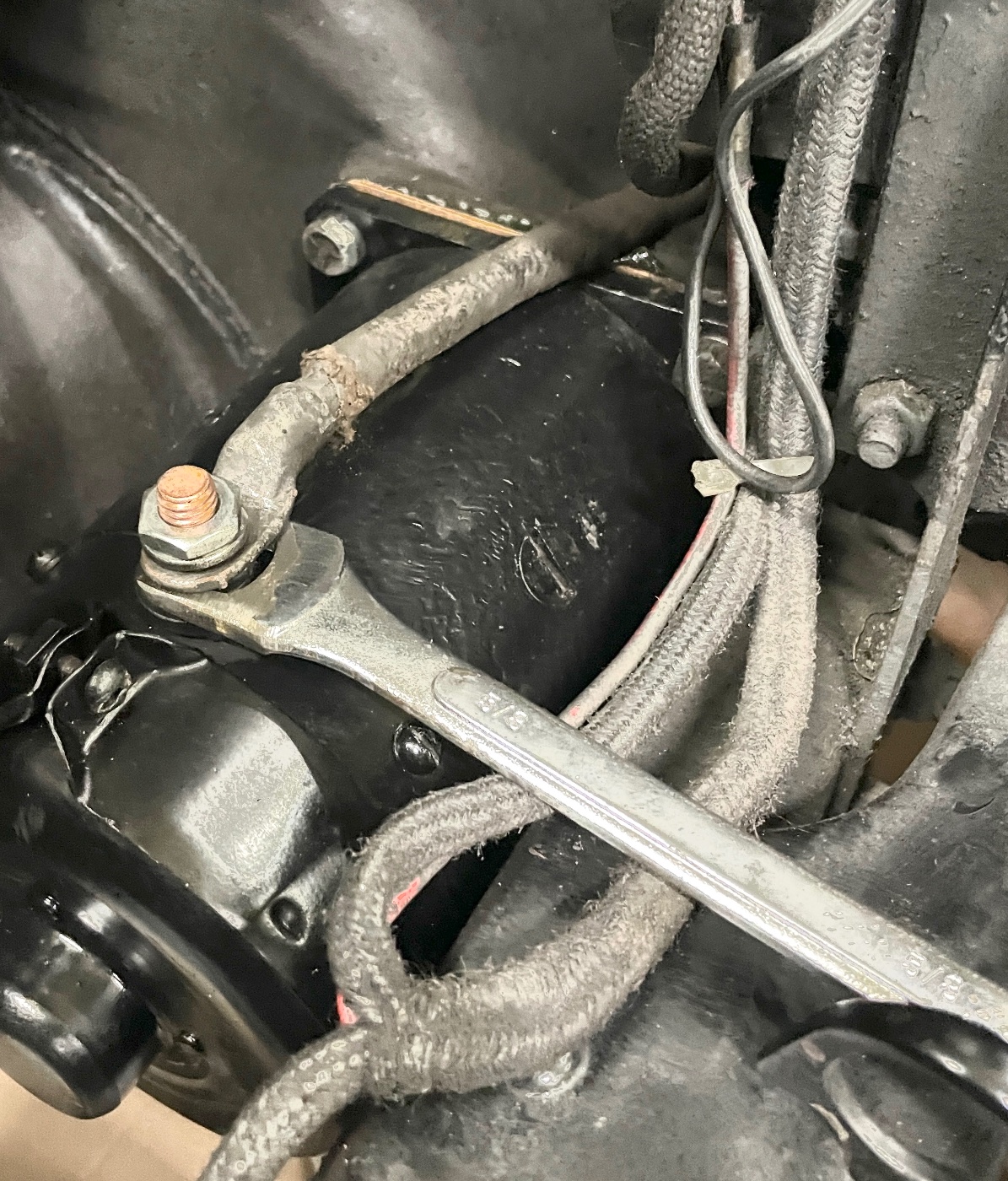

by John kuehn
Dan!
I like your 5/8 wrench with the ground down sides for getting to those nuts/bolts in tight places. I’m assuming it’s been ground down. Ive done that a few times.
Re: Starter motor mounting screws or bolts?
Posted: Tue Nov 19, 2024 2:17 am
by Allan
Dan's modified wrench is something every T owner should have.It needs to be thin enough to fit between the insulating bushing and the cable terminal. The first nut is done up just tight enough that the bolt is firmly in place. When the cable is hooked up and the top nut wound down, the wrench holds the nut while the top one is tightened. This stops the bolt twisting at the contact with the bus bar, protects that soldered joint from being broken and at worst, prevents the bolt actually breaking out of the bus bar.
Posted: Tue Nov 19, 2024 11:09 am
by RajoRacer
Thin wrenches are readily available - I have a set from 3/8 - 7/16 up to 11/16 - 3/4 - quite handy for tight spots !
Posted: Wed Nov 20, 2024 12:11 pm
by TXGOAT2
"Tappet wrenches" are good to have, and a cheaper set can have the heads ground back if necessary. They are usually thin enough as they are made.
