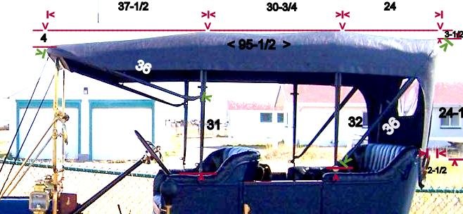

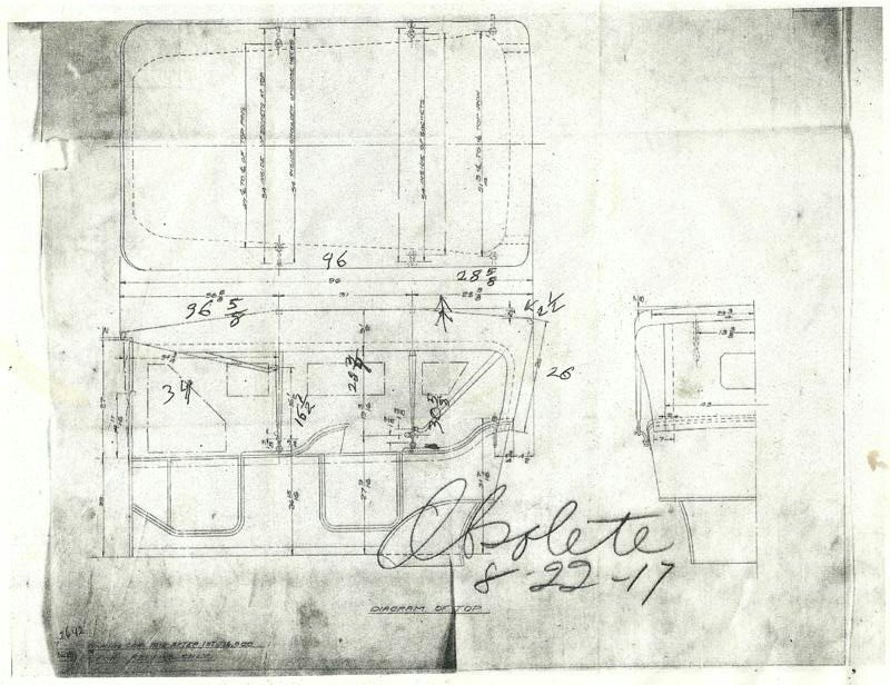

I have the following info that has been posted on this forum over the years. Les

Les,
Thanks for posting the drawings!

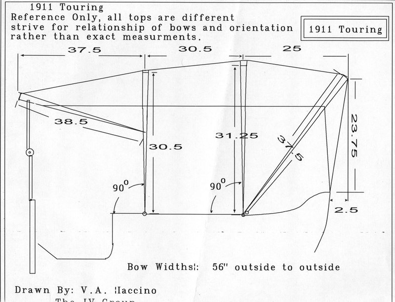

It turns out that I have very good agreement with the drawing below. I do believe that my bows are original. The problem is that the rear bow, #4, has been broken and crudely repaired with a splint and the front bow, #1, has a significant bow inward where it should be straight. I purchased 4 new bows from Langs which are supposed to have an inside dimension of 54 inches per their website and 3 of my original bows are 53 1/2 inches. Although bows #2 and 3 look good they will not stack when down with just 2 new bows ( #1 and 4) such that I think that I will have to replace all 4 bows.

Using four new bows which are all the same width is the way to go. Wood bows naturally tend to open out if not stored with a tack strip between the "legs" This tendency is your friend. Pulling them back into line will raise a small crown across the top, alleviating the inwards curve you mention in the front bow, and adding crown on the other three.
I have two observations to offer. Pay attention to the lay of the back bow. The back curtain should be well to the rear of the back panel, or your car will have a hunched back look. The second and third bows should be the same height.
If you are contemplating installing the new top yourself, setting the bows correctly is of paramount importance. I hold them in place with thin timber laths tacked to the under side of the bows, and on the inside of the back bow. This allows you to adjust how they lay and their relationship to each other, and hols them firm while you add the pads and top material. Even then, I let my trimmer do the fitting.

"Ward, When your top is folded, do the tops of bows #2 & #3 line up? When #2 is in the folded position its pivot point is the same as #3 pivot point. If the bows are the same length they will line up when folded. Also, when folded, the pivot points for bows #1 & #4 are both 1 3/8" above bows #2 & #3 pivot points. That means if bows #1 & #4 line up when folded, bows #1 & #4 are the same length."
Yes, bows 1 and 4 are the same length, and bows 2 and 3 are essentially the same length (within 1/8" to 1/4") on this particular 1911 touring.
Do others find that the #1 and #4 bows are the same length such that when folded down #! and #4 line up? #2 and #3 line up on my 1912 Touring however #1 is shorter on my car such that #1 and #4 do not line up when folded down. When stacked the #1bow is 3 inched ahead (shorter) than the #4 bow.

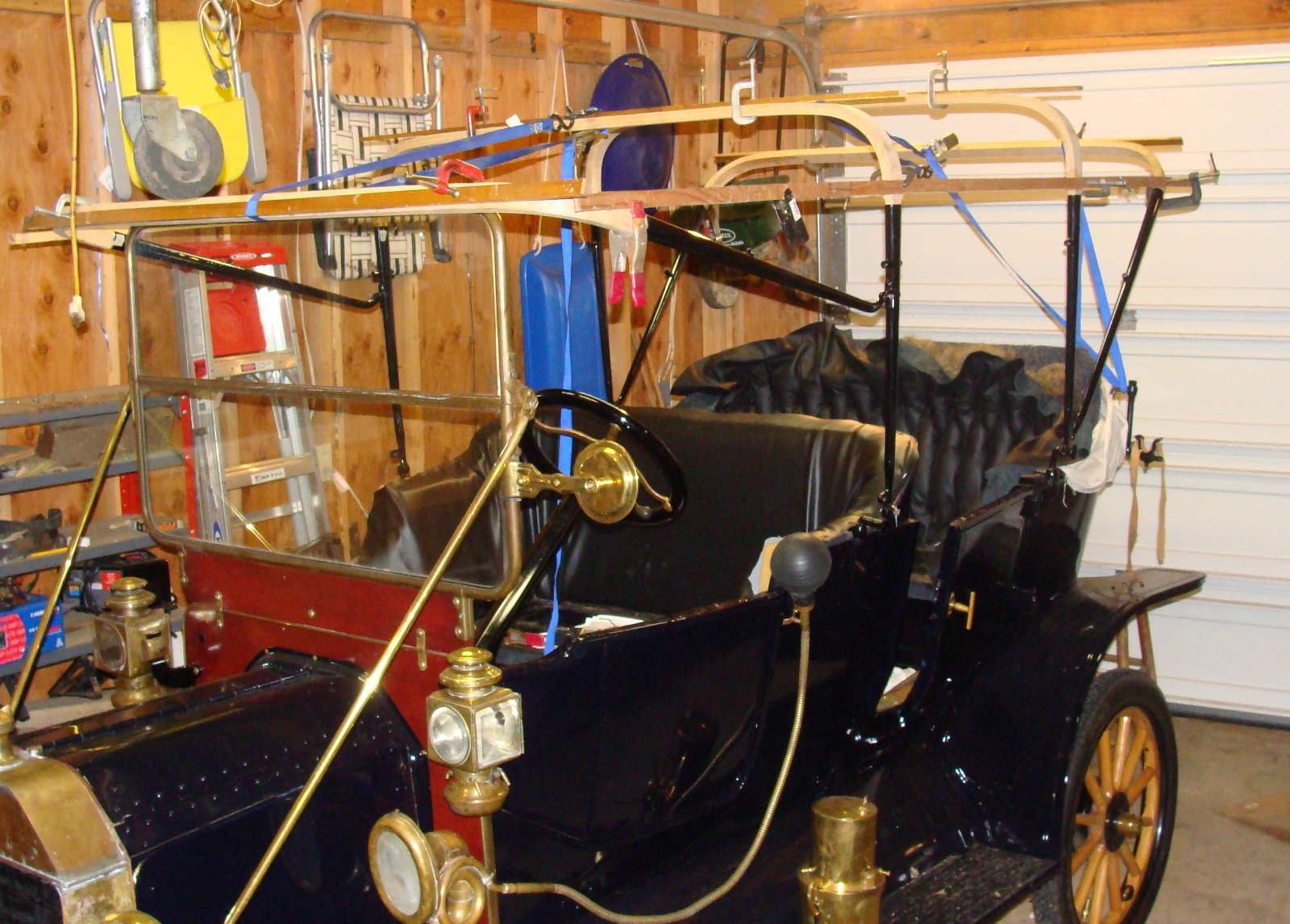

When the top is folded down on my 1911, bows #1 and #4 and even and #2 & #3 are even.
When the top is in the up position, the total vertical height of bows #2 and #3 are even.
Take your time to line up everything.

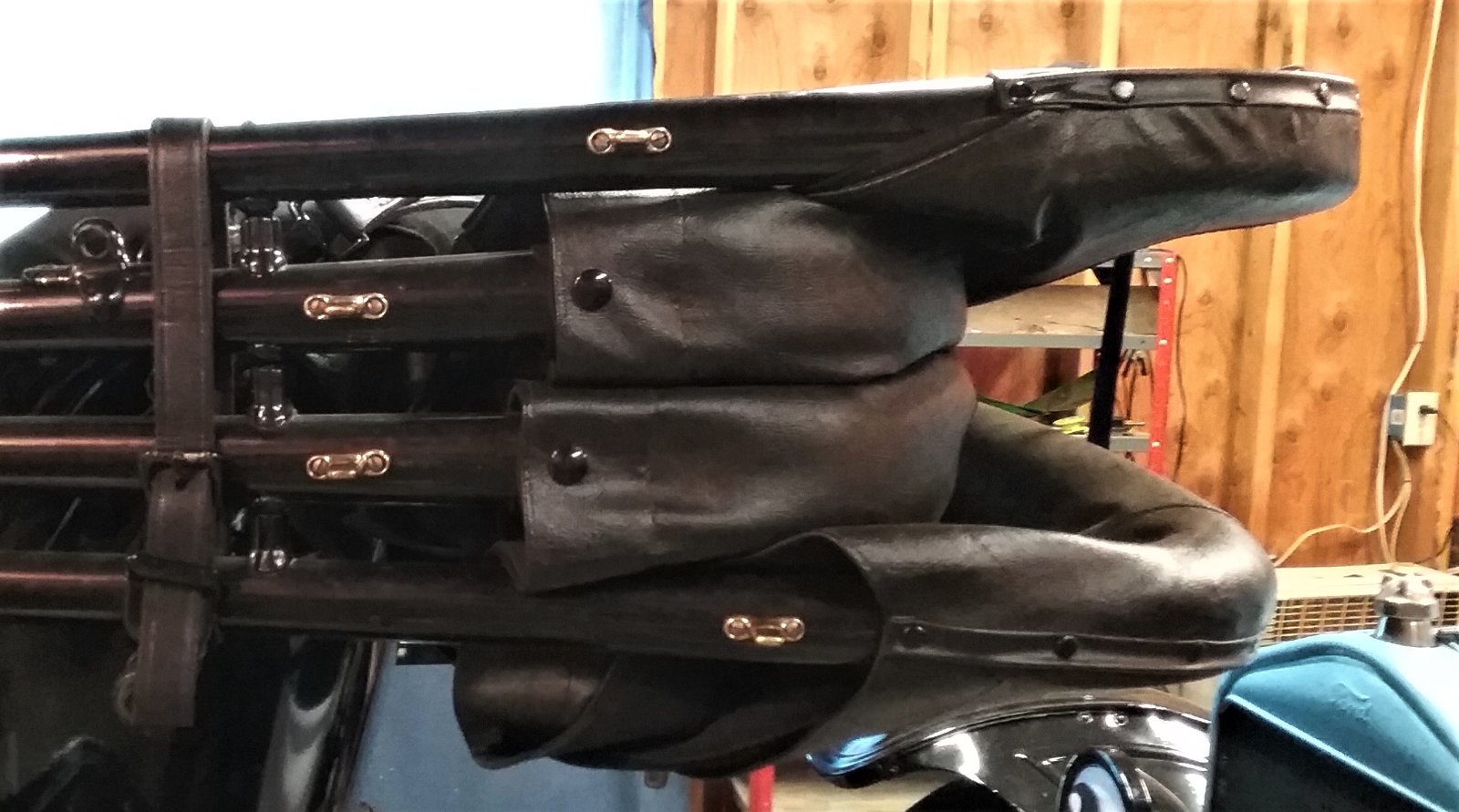

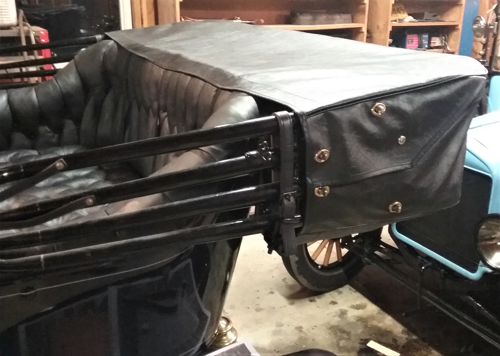

I made this pattern for a top boot. Mike at Classtique made it for me and has the pattern.
-Keith
-Keith

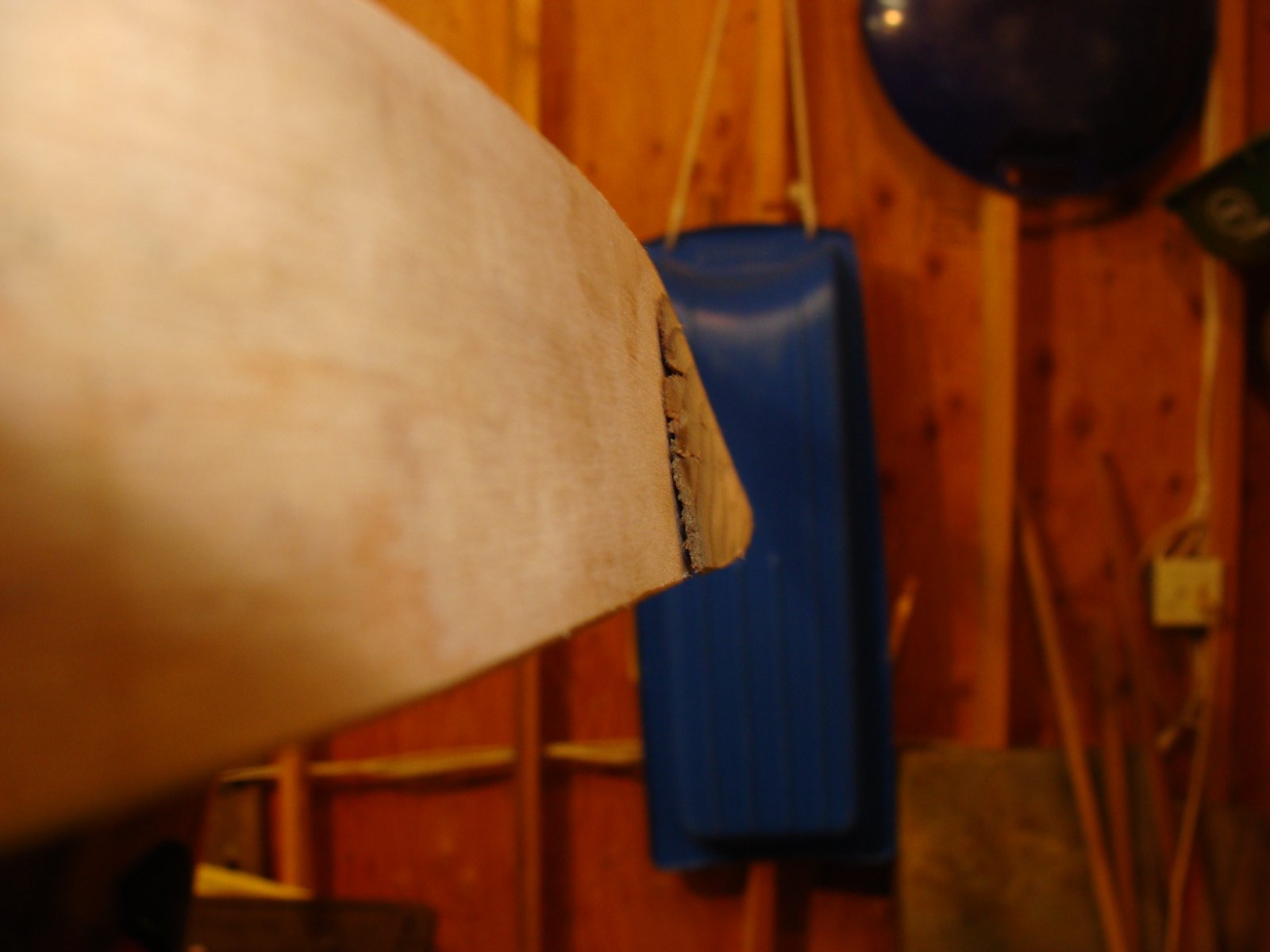

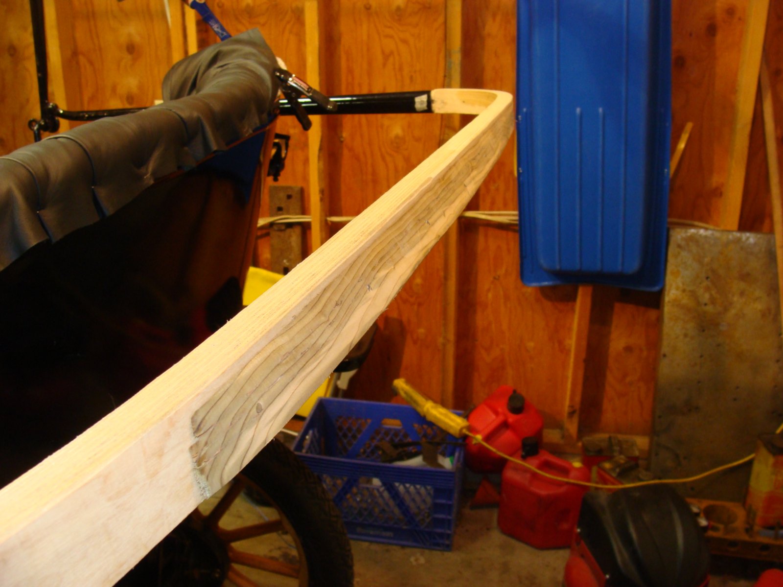

Many thanks for the post with excellent photos and dimensions. Not sure that I understand the "wedge". My #4 bow is very bad with several repairs. Does the wedge increase the thickness and arch the #4 bow?

Here are a couple of pictures of the #4 bow "wedge" that I created:

- Posts: 7126
Re: 1912 Touring top drawing needed
A thin wedge like that will help retain a slight upward bow in the rear bow. The rear bow takes a fair load, being pulled down by the rear curtain, forward by the top and every which way by passing traffic, especially trucks. I know it is not a Ford factory item, but a 1 1/2" wide x 3/4" thick board, shaped to follow the inside profile of the back bow, makes an excellent stiffener for that bow. They are standard issue on some of our colonial built cars, including my wide body Duncan and Fraser built roadster.
