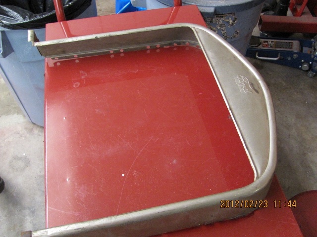

Image 5-3-20 at 1.13 PM.jpeg (23.13 KiB) Viewed 11407 times
The std black steel shell, T-3974C, Factory #8737C, came out in 1923 for the 'high' radiator and fits 1923-1927
There isn't any design difference in side panels, but the brass nicked plated ones usually have round holes for the welting lace, as opposed to the early ones with square cut away notches, as that type would be hard to bright finish on a revolving polishing wheel.

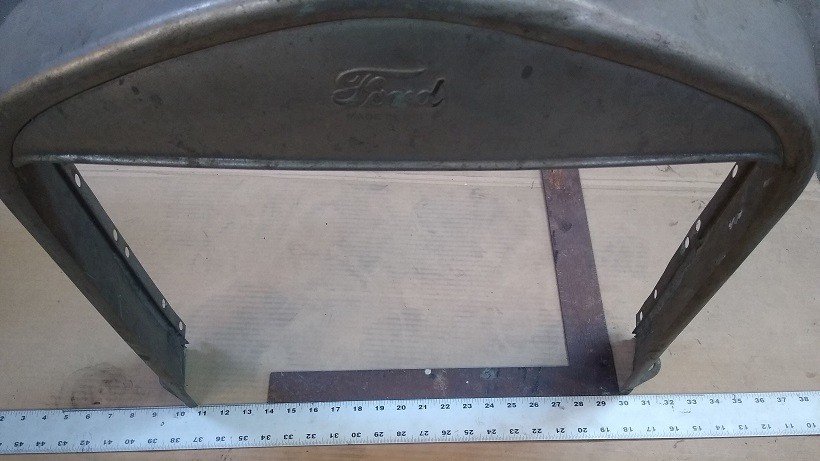

If there is a question about your shells, maybe post a photo like this to show the flare of the high shell:
Vern (Vieux Carre)

Vern, your phpto has the top corners cropped, so we can't see the flare. If the feet at the bottom are shown, they will be angled to show the flare. Those feet are narrower at the back than the front.

I suppose even though that photo does not show enough detail, the concept remains that the OP could post a photo of each in question.
Here's my other one from two years ago if this is better:
Vern (Vieux Carre)

Vern, it is better if the foot piece is still fitted. That would show the back edge narrower than the wider front rolled edge, clearly illustrating the flare.
