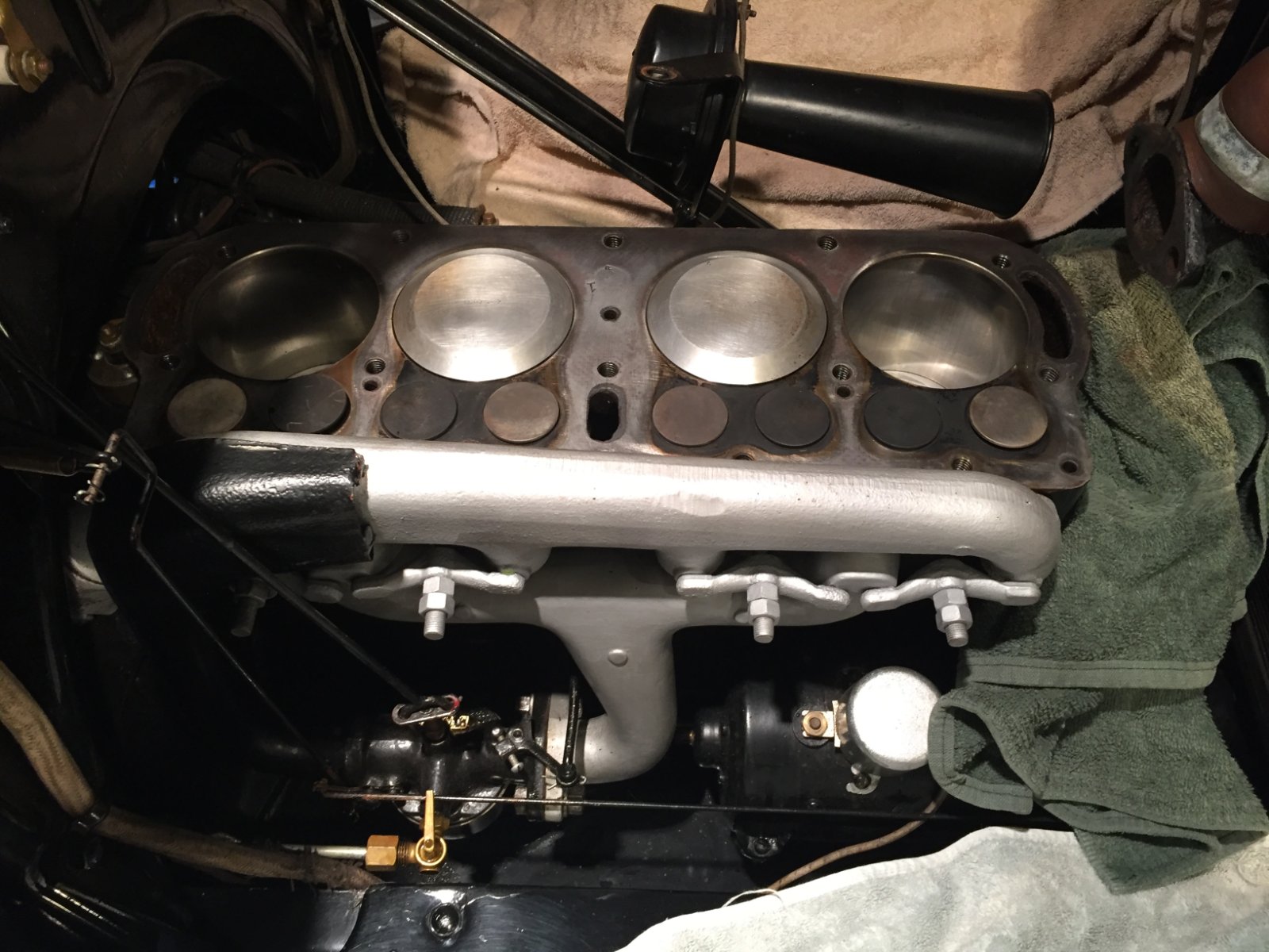

Well i finally decided after much thought, and some inspiration by others i know, to install the Prus head i have had sitting on my shelf for a few years now. ;) I still have a few questions that i hope some of the great minds here can answer. From what I've read, I'll need less advance for normal operation that i usually run V.S a stock head, and its better to drop the spark gap from .030 which my engine prefers now, to .025 for the H/C. Any thoughts and experiences would be greatly appreciated.

Thanks for the input, i appreciate it. ;) Got it done today without a hitch, and will run it tomorrow. Had the head off about 600 miles ago to replace the valves and add adjustable lifters and it looks like everything is working pretty well inside. :o Thanks Again.
