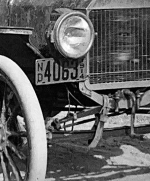

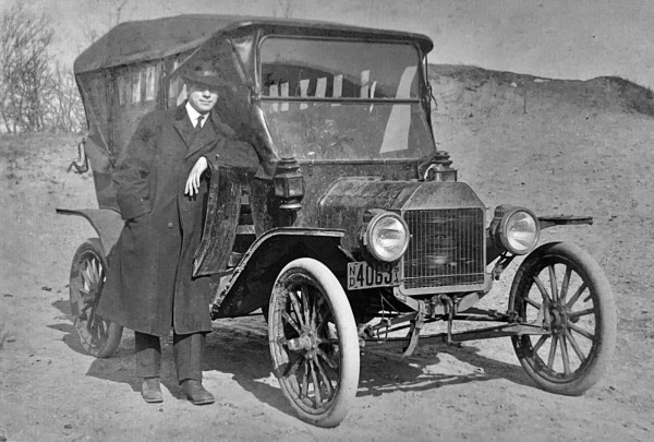

This photo was shared by dollisdad in Friday Flicks. It shows a belt around the front axle. I've seen this in other old photos too. I presume it's some sort of top-out limiter? Can anyone shed light on this? Was a belt used on the rear axle similarly, or only the front?

My original, unrestored 1907 Autocar has them in the rear. They were very common and were made of very thick retanned leather.

Yes These leather straps help to control rebound of the transverse springs. Many type made, some straps only, some with spring assist, esp. for the Ford.

Regarding the free length of the straps, I adjusted them so that they hung about 1/2 inch below the bottom of the axle when the car is on the ground. Purely a rough guess on my part, but it seems to work well. If the belt didn't have a buckle hole in the right place, I added one with a punch.
I believe that the car appearing to be off the ground in the first pic is an illusion, that yellow thing is a wheel chock.
