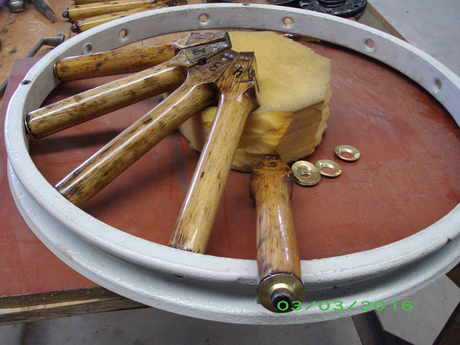

Allen : here are some pictures of hoe I do the wheels, when they talked to me [ claking]
Toon

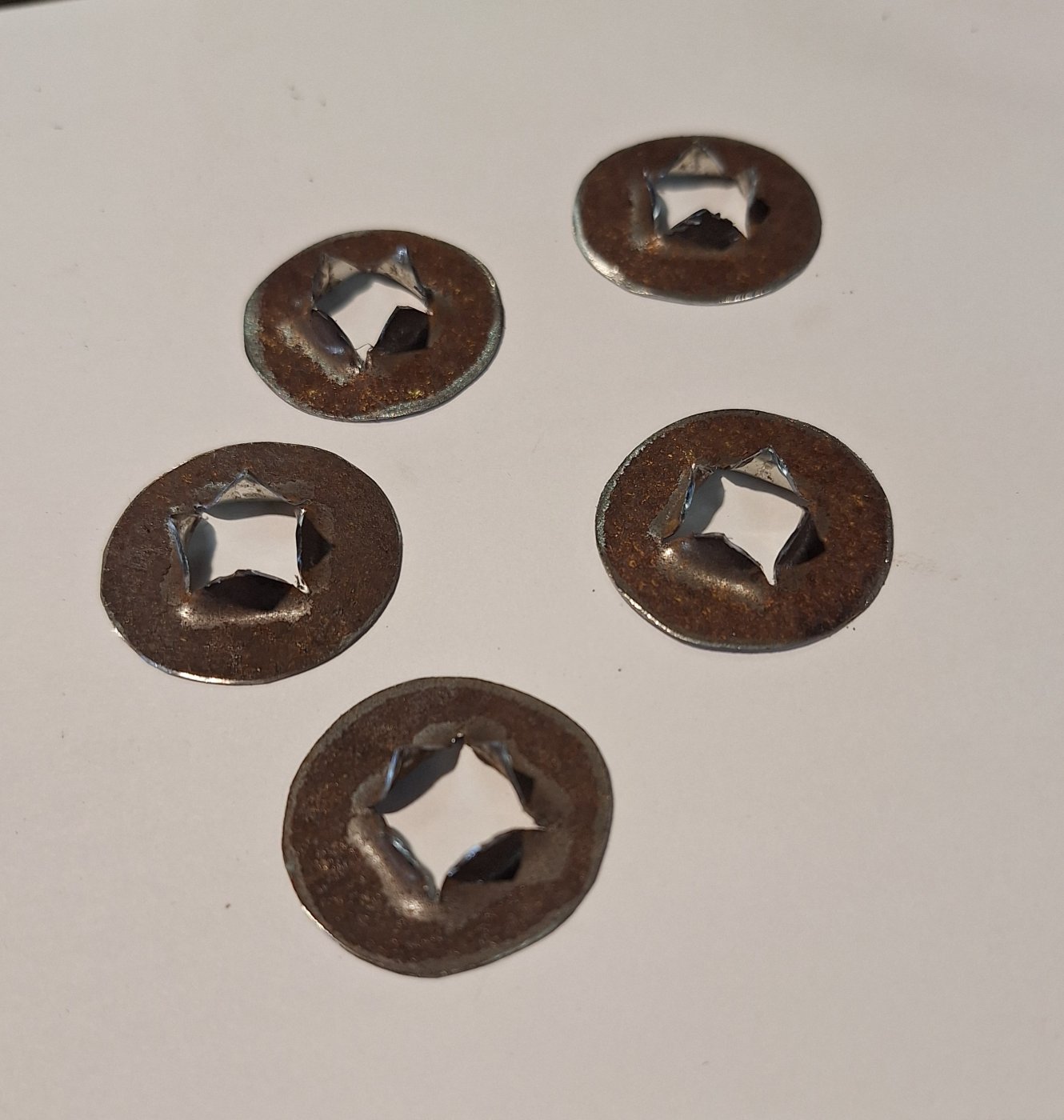

Back to the task. These shims were hand cut from a metal 4 gallon thinners drum. The brass shim I have was either way too thin or too thick
The crossed cuts were made with a Dremel slitting tool. Once they were done I used a blunt tapered punch to form the four points. These help to centre the tenon in the felloe hole. I will use. Some epoxy around the tenons just as a filler for any small gaps.

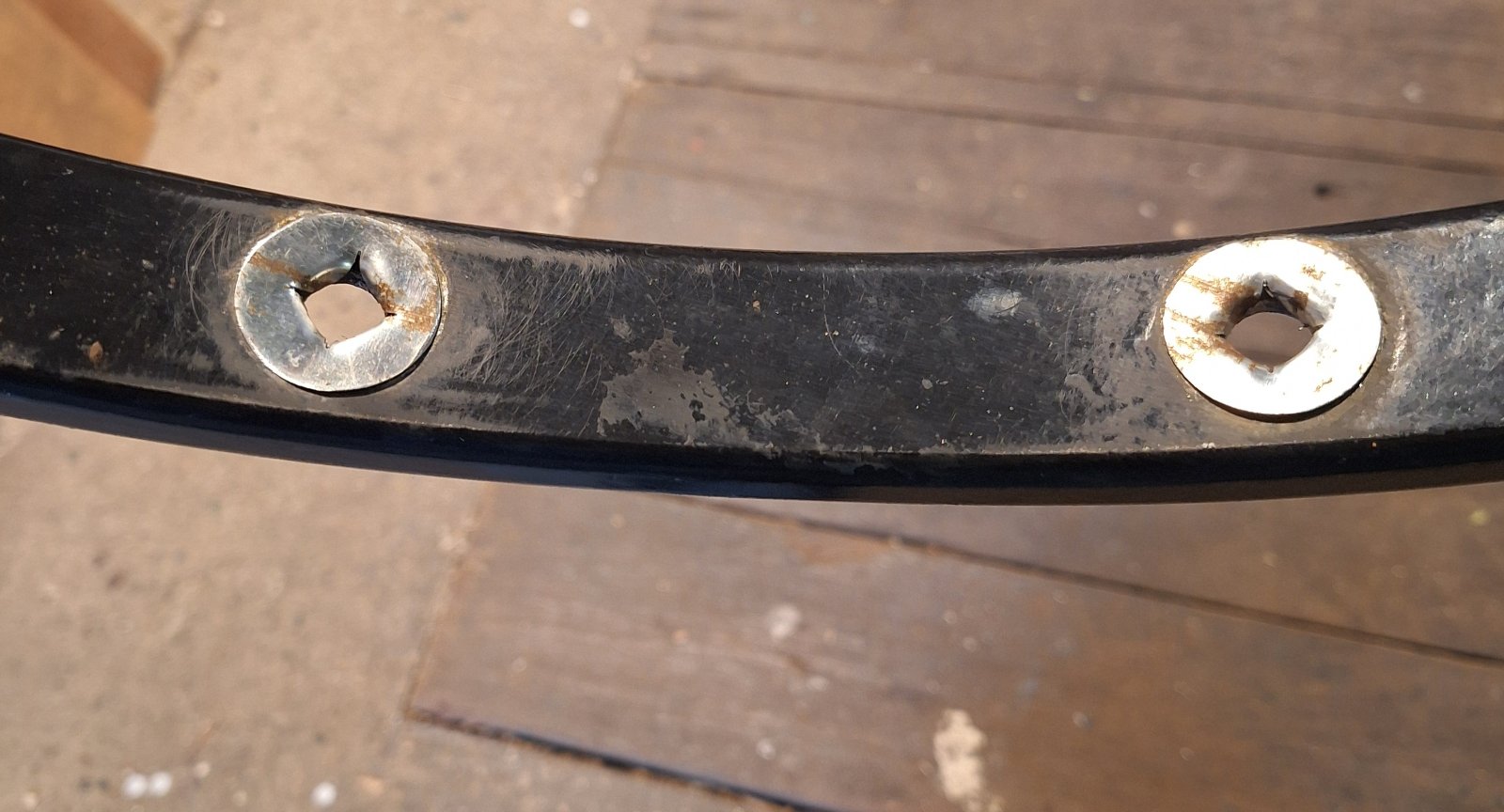

Here is the wheel reassembled with the shims in place. They made it too tight to drive the spokes all the way down, so it's off to my mate's workshop to use his power press
My workshop press is not wide enough to take a wheel.
