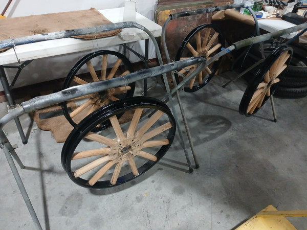

After I removed the hubs, I began experimenting with sanding the spokes. I started with 60 grit sandpaper and going with the grain, resisting the temptation to wrap a piece around the spoke and go the other way. DON'T SAND AGAINST THE GRAIN. I spent probably 3 or 4 afternoons after work doing this for 3 or 4 hours. I got through the first sanding and realized that I needed to find a betrer way if I wanted to complete this before I was 60 :lol:.
I decided to use a dremel tool and an 80 grit sanding flapwheel. I tried this in the garage, and soon regretted my decision. Very dusty! I should also add that its a good idea to wear ppe to protect you from the dust. After getting a mask and opening the garage door, i found that the flapwheel worked great. It quickly cut through the surface and it left a nice finish without hurting the wood. I let the flap wheel wear down and after the diameter shrunk I was able to get in by the tenons and were the Hub sits. I should add that you need to be careful of how hard you press especially when you get down toward the Hub so you don't leave a little u-shape in the spoke. I ended up doing some of this by hand anyway but the flap wheel greatly helped.
Skipping ahead a bit, after I worked on my hubs, I finish sanded my spokes by hand, paying close attention to the outer and inner ends of the spokes. I used 120 and 220 grit paper.

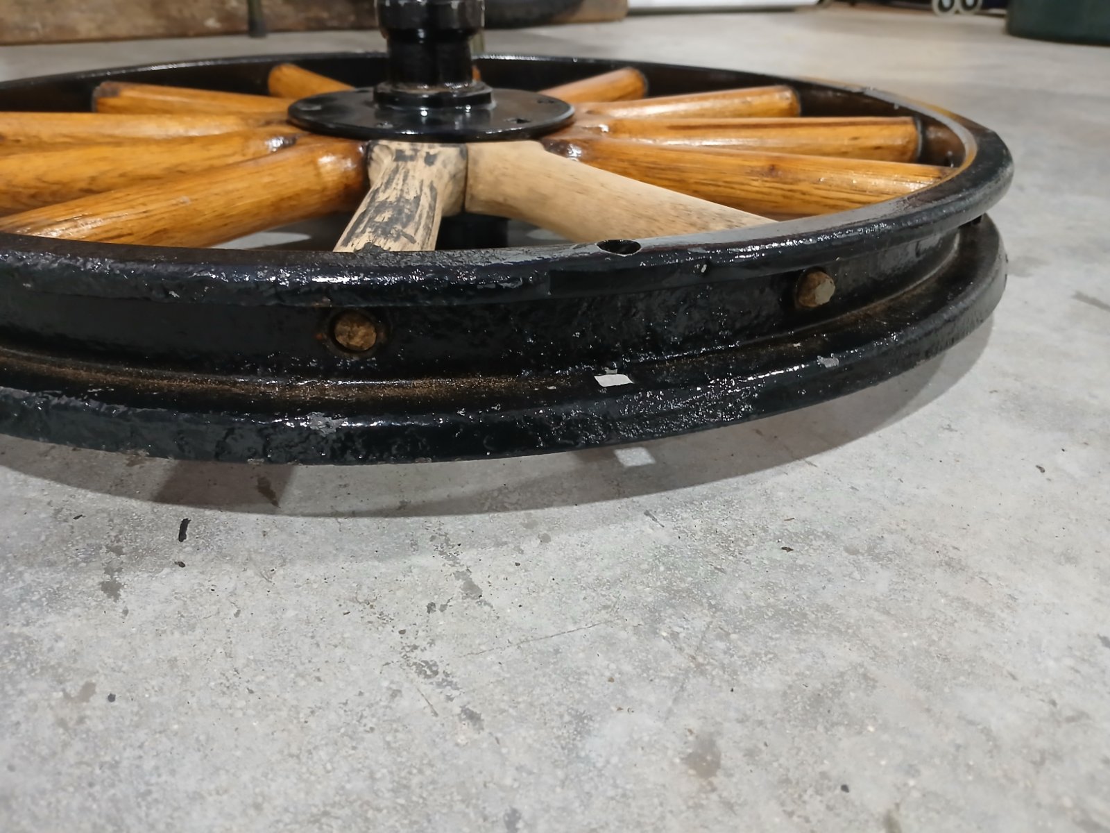

Once all of the hubs had new races, I could focus on my rims again. I decided I wanted to sandblast the fellows, without removing the spokes. I took masking tape and covered all of the surface before I sandblasted one wheel, it turned out better than I thought, so I repeated the process with the other 3 wheels. I should note that I finish sanded my wheels with 220 after this.
Once they were blasted, I removed all of the tape and labled the wheels. I then replaced the tape with new to prep for painting. I didnt want any of the sanding dust in the new paint. I primed the fellows with rustoleum self etching gray rattle can primer. It seemed to do alright. I also primed my hubs. I painted the hubs and fellows with rustoleum gloss black farm implement enamel with krylon catalyst hardner. I mixed it approximately 8 to 1, more or less.

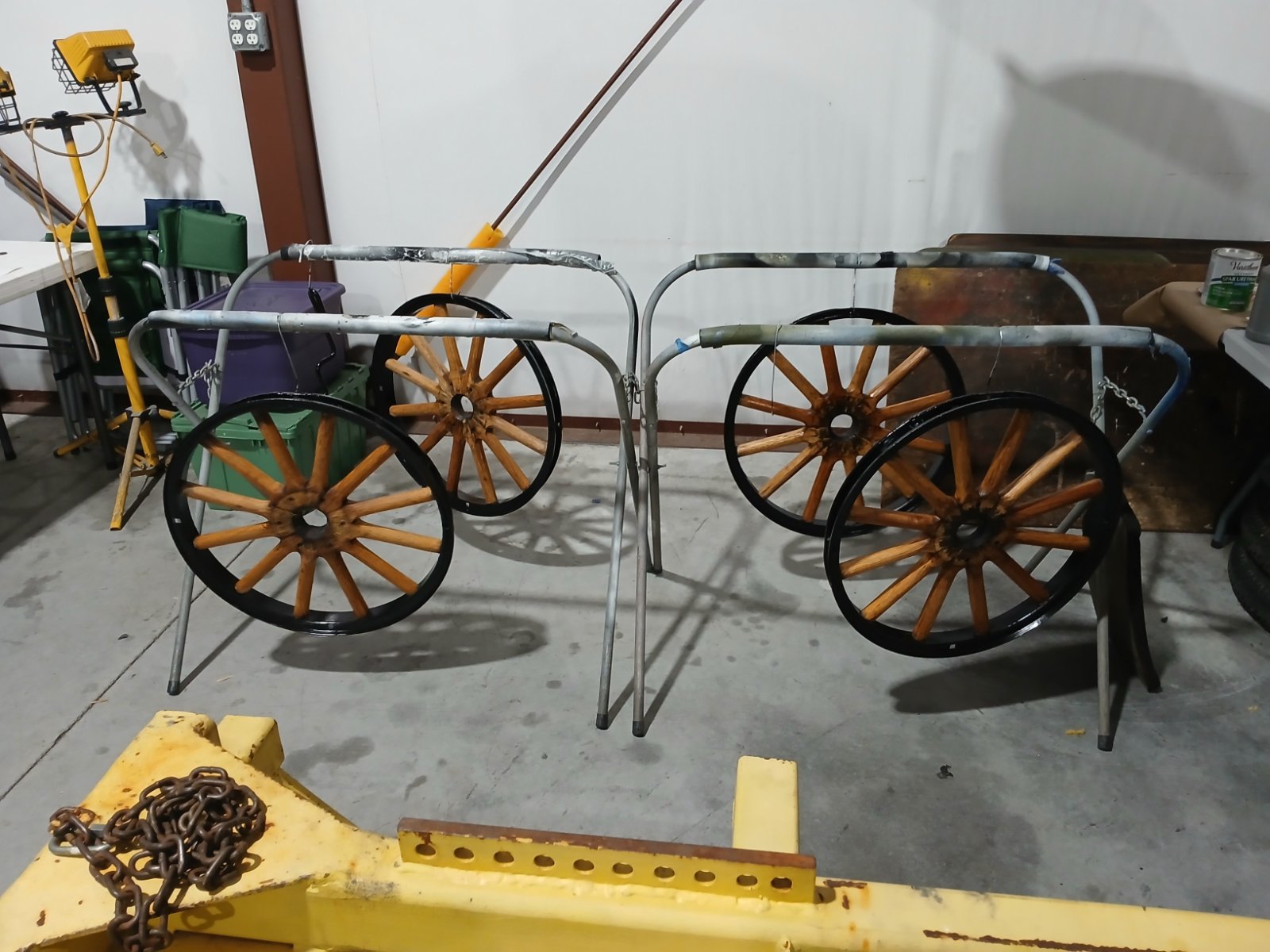

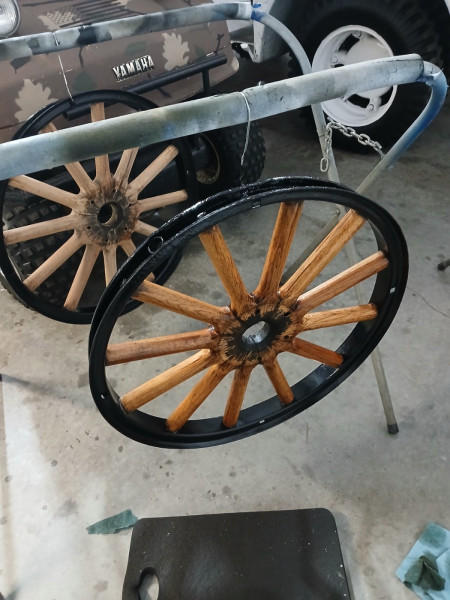

I painted my rims twice, with just a brush, and they turned out pretty well. After the paint dried, I started working on the staining. I decided to use watco teak oil and rustoleum/varathane varnish to protect them from the UV. I brushed on 3 coats of the teak oil with a bristle brush, being careful to avoid bubbles. I let them dry between coats for about a day. Before I started on the clear coat, I let the wheels dry for about 3 days. This cures the teak oil.
I brushed a total of 3 coats on the spokes of the clear polyurethane.
At this point visually, all 4 wheels were done, however I didnt feel comfortable with the left front wheel. I had noticed when I first took the wheels off that 2 tennons on the front wheel were starting to deteriorate. I was hoping the paint and stain would help rejuvenate the wood and harden it up to a useable spoke. For a week or two I was trying to lie to myself that it would be okay. I almost kept it the way it was but I just kept thinking about it and I decided that it was best to just replace those two spokes. They were a little bit loose and shrunk in the fellows so I would have had to do something anyway but I feel better that I decided to replace them. I was worried that two different spokes might make the wheel out of round or make it crooked or wobbly. I first tried to find a couple of good used original Spokes in some of my grandpa's old stuff. I found one that cleaned up quite nicely but the tapered end was cut on an angle and sat crooked. I was hoping that the old spokes would help blend in and not be noticeable, because I was trying to go for a medium finish without completely taking out 100% of the imperfections in the wheel. I worked on the two spokes for a week or two before I decided I better just buy a couple new ones. I'm glad I did I feel a lot better about it in hindsight.

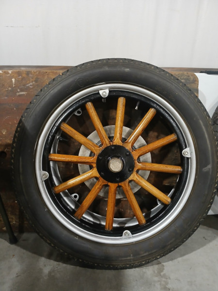

Once I got my new spokes I sanded them and varnished them with the teak oil and clearcoat. I drilled the holes for the hub bolts and installed the hubs. I am happy with how the wheels turned out and unless you look close the two new spokes look pretty much like the old spokes. I should add that I decided to buy another can of teak oil mixed with stain to help blend in the new spokes with the old. It worked out relatively well. Around the time I was waiting for all of the finishing to dry I cleaned the outside of my demountable rims and brushed two coats of aluminum infused paint on the rims. They turned out well and look pretty nice in my opinion. I cleaned off a little bit of the paint that got on the tires with a dab of brake cleaner. I also added discs on the rear wheels in replacement of the drum because I am adding disc brakes on my car. I torqued all of the Hub bolts to roughly 45 lb. I mounted my tires on the wheels and did a couple of small things like experimenting with polishing a few of my hubcaps and called it good at that.
Re: Refinishing a set of wheels, my experiences
Posted: Sun Mar 16, 2025 2:05 pm
by 1925 Touring

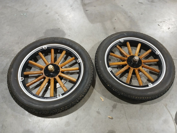

Aside from a few smaller things, my wheels are done and ready to roll. :roll: I enjoyed the process and found it challenging and a good learning experience and I learned a lot. I encourage anyone else who is not trying to build a professional restored car to give it a go. I was quite intimidated by the idea at first especially when I took out the hubs, but I feel better about doing it again. I have mounted both of my front wheels and installed new bearings they are whisper quiet and roll as straight as a Model T wheel can roll. With with all of my supplies, teak oil, polyurethane, brushes, paint, hardener, and paint prep I had a little over $100 invested in my wheels. If I would have had to buy new hubs that would have up-ed the price but I was fortunate enough to acquire a few used hubs. It took more time than anything but hopefully now they will be good for another 30 years. I have yet to drive a foot with the new wheels and it will be interesting to see how they age, I won't promise anyone that this is a tried and true way of doing it but at least it gives you some ideas if you decide to do it for yourself.
Thanks for reading! And good luck with your Model T projects.
