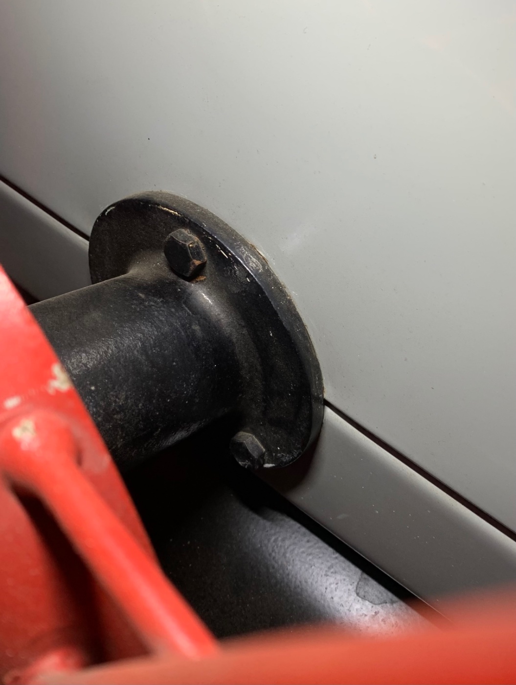

Just to pile on, this is what my ‘27 Runabout spare tire mount bolts look like.
Keep crankin’
Eric

by RajoRacer
Great photos, Eric !
