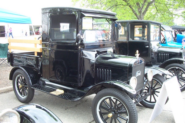

This photo from the recent Friday Fill up thread might provide inspiration for converting roadster body to C-cab.

ohhh, that's purdy right there....

Here is a variety of body parts together on a T chassis.
'24-'27 TT closed cab body, mounted behind is a '26-'27 runabout pickup metal bed...... ;)
