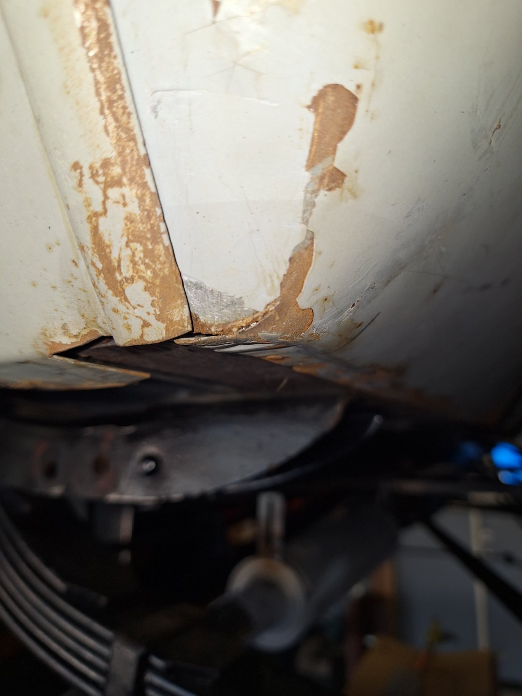

What is the latest and greatest method to weld up a Crack on this 100year old 20 gauge? Might, Tig, Gas...?
Not my wheelhouse.

Jeff, post a pic of the crack.

TIG welding using a copper back plate with multiple cool cycles and doing pearls instead of a continuous weld.
Hank

Thank you. I have the copper, and a Tig guy.
