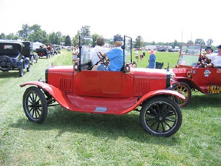

Post by DHort » Mon May 19, 2025 12:51 pm
Maybe you want to install another front end and ditch that rear axle.
i think that is what the guy did here.
