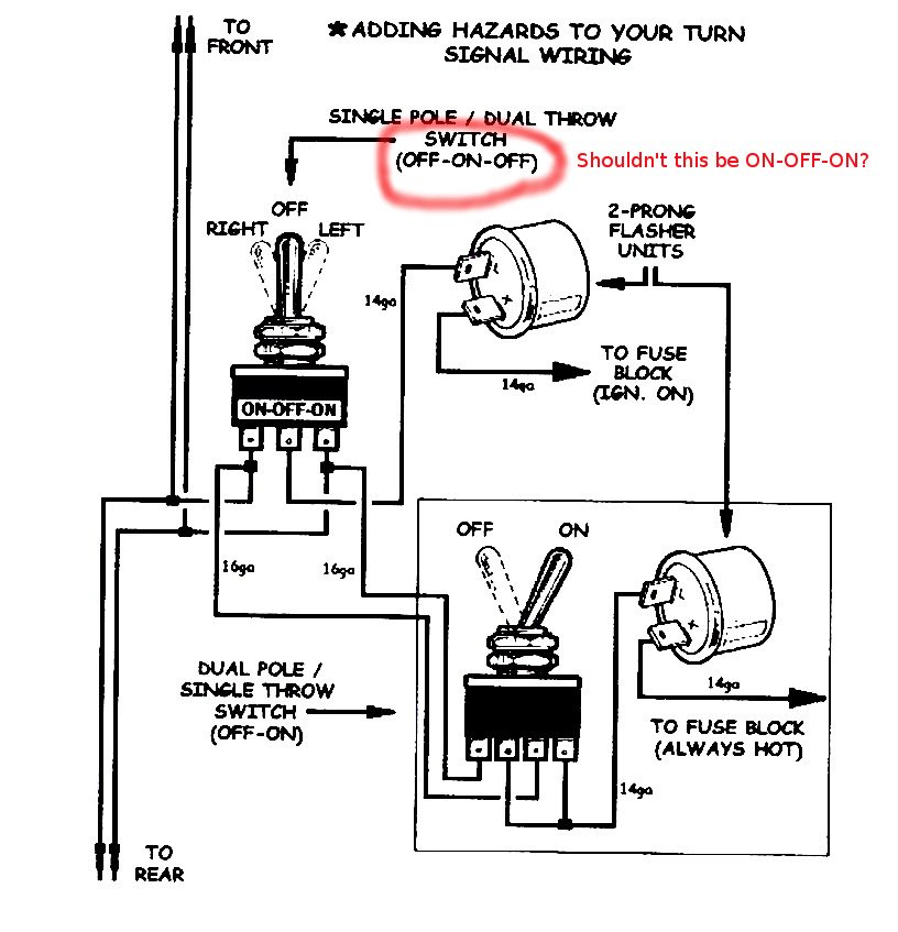

Here you go folks! Simple, works Great, the hazards are optional.
All the Best,
Hank in Tin-A-See
Re: LED turn signals?
Posted: Thu Jun 27, 2019 6:58 pm
by A Whiteman
Hank, that is a nice touch and looks easy to add it in to the existing wiring. Might give it a go :-)
Posted: Thu Jun 27, 2019 7:04 pm
by Henry K. Lee
Thanks!
This is to be added not incorporated to existing wiring. If you require integrated like a modern car with dual brake lights, etc let me know and will post the schematic for it!
All the Best,
Hank

I have not figured out putting the flasher before the switch. Usually on a set up we would be using on a T would have 2 flashers after a 3 position switch. One for the feed to the left lights and one to the right unless you were mounting a regular turn signal control which is designed to use 1 flasher.
Posted: Thu Jun 27, 2019 11:27 pm
by Steve Jelf
Looks like that diagram should do it, but...

Yes Steve, sorry, simple typo.
Hank
