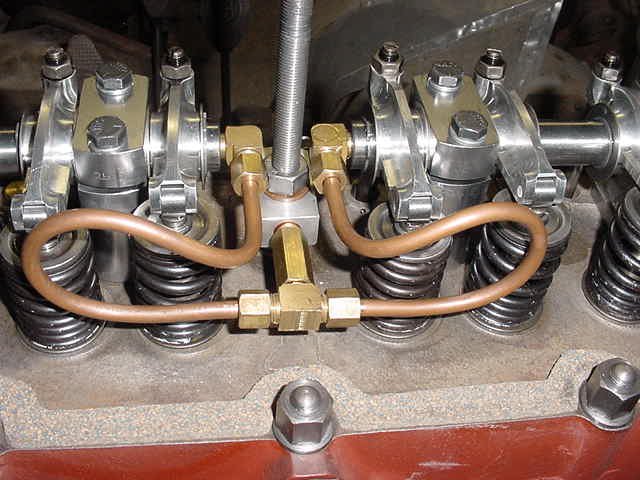

Both Roof and Frontys I have done the same way fundamentally…. Make a spacer 1/2’ thick. You can then drill and tap a 1/16 pipe thread oil line fittings Sent you a text
Shown is my Fronty set up
Re: OHV question - oil pressure to rocker arms?
Posted: Fri May 23, 2025 11:32 pm
by KWTownsend
Mike,
That is entirely too beautiful.
Those Fronty rocker arms are exquisite!
