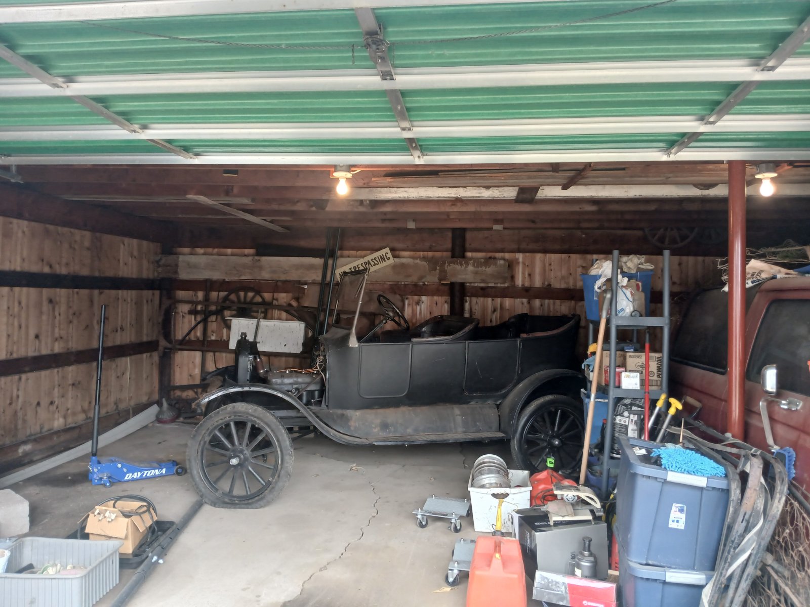

The first thing I had to do was pull it out of the back corner of the garage where we had put it after we bought it. I was able to jack the 20 centerdoor up and put it on dollies and get it out of the way. I was able to put the touring in gear and use the crank to pull itself out of the corner and eventually into the open. (All the tires were flat).

I started working on getting the car ready to run this week after work when it wasn't too hot. I found a lot of the headbolts loose, so I tightened them up and filled the radiator with water and left the drain plug out of the pan. I rebuilt a coilbox quick because we had stole it off to replace the one that went bad on the 25. I replaced one of the tires with an old spare I have, and aired up the rest. One has a chunk out of it and you can see the cord, so that needs to go too. This saturday, I went through the fuel system. I took the carb apart and sediment bulb and cleaned everything. The gas tank was full of old gas and dirt. I poured vinegar in and flushed it out the best I could. After that, I was happy to see my fluid level in the radiator had not moved much so I'm hoping that I don't have a cracked block or anything. The front wheel bearings were very bad. They both fell apart when I removed them. I replaced those and with a new battery and some gas, I primed it, and it started! It ran great! I am very happy how easily it started. I let it run a bit and drove it a few inches. The handbrake, I found needs to be replaced. The car was idling, I was in the car when the lever released and it put itself into high gear. Luckily it didn't go far but the gear and pawl needs replacement. I was able to drive the car around the block and up and down the road a little. I'm very happy how responsive it is.
